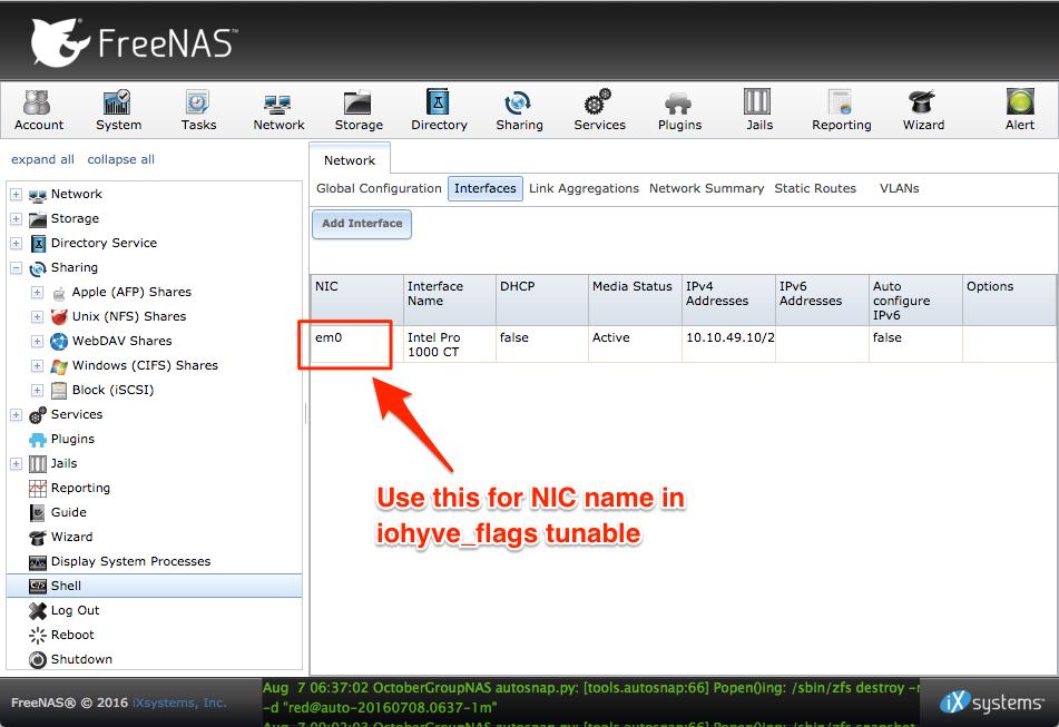

  2. Find NIC name in GUI:
m0nkey_

Tunables need to be rc.conf type. Iface is whatever network interface you have configured on FreeNAS. In my case, it's lagg0 since I have link aggregation set-up. This may be in your case em0, or igb0 (if using Intel NIC).
