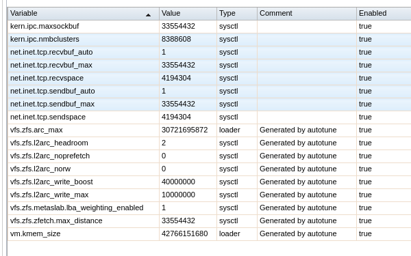

Hi I'm seeing very slow scp transfer speeds to FreeNAS baremetal install. Using a 1Gbps network and iperf shows raw speeds are normal. This is a basic setup with scp moving iso on nodeA to freenas and vmInFreenas, where "freenas" is baremetal and "vmInFreenas" is fedora-server-26 in bhyve (on FreeNAS baremetal). I'm seeing 30MB/s to FreeNAS, but a VM in the same FreeNAS host transfers at 112MB/s. Initially FreeNAS speeds were 2MB/s (_really_ slow, eh) a few sysctls helped move it up to 30MB/s.
The list of things that I have tried:
  • Clean install of FreeNAS 11 and only configured ssh for scp.
  • Clean install of FreeNAS 9u4. Slow as well.
  • Cleared settings on a spare router and configured clean FreeNAS and nodeA with 192.168.1.0/24 subnet and DHCP, and only two devices on this subnet. No change.
  • Set some tunables; tried autotune; a mixture of both. See attached screenshot of sysctls to move from 1MB/s to 30MB/s.
  • Captured iperf and scp timings. See below. I used strace and compared between the slow and fast transfers; both have about the same number of write calls, just much different in how long it takes to write.
Any ideas on what is wrong with the setup? It doesn't appear to be hardware.

Turn off autotune and remove any tuneables it created.
Autotune is known to slow down systems and there are a very few rare cases where it should be turned on. I've asked for this feature to be removed or a HUGE RED WARNING sating the known issues with it.
https://bugs.freenas.org/issues/24112

Sure, I started without autotune and the system was at 1MB/s. I have a strong dislike of autotune magic because the majority of ctls I can't find documentation. I support its removal.
Does everyone see 30MB/s speeds on 1Gbps with FreeNAS? I've used it for 7+ years and always assumed it was my (shit) hardware but I've upgraded to the fancy components listed above.
Looking for any suggestions to figure this out.

I attempted to disable data encryption with `scp -c none ...` but unfortunately the client side doesn't show the selected cipher. And the freebsd sshd_config manual makes it sound like the none cipher isn't available.
EDIT: Oops, I didn't finish the thought. I'm thinking it's a mixture of missing sysctls and ssh.

I found that this is an openssh issue with the chacha20-poly1305@openssh.com cipher. At least, that's the best I am able to assist solo.
I opened a ticket to track this issue https://bugs.freenas.org/issues/25383
Workaround:
  • Remove chacha20-poly1305@openssh.com from the openssh cipher list.
  • Removing that cipher increases transfer rate to 50MB/s. Use these systctls to get the FULL 1Gbps rates:
    sysctl kern.ipc.maxsockbuf=33554432
    sysctl net.inet.tcp.recvbuf_auto=1
    sysctl net.inet.tcp.sendbuf_auto=1
    sysctl net.inet.tcp.sendbuf_max=33554432
    sysctl net.inet.tcp.recvbuf_max=33554432
    sysctl net.inet.tcp.recvspace=4194304
    sysctl net.inet.tcp.sendspace=4194304
