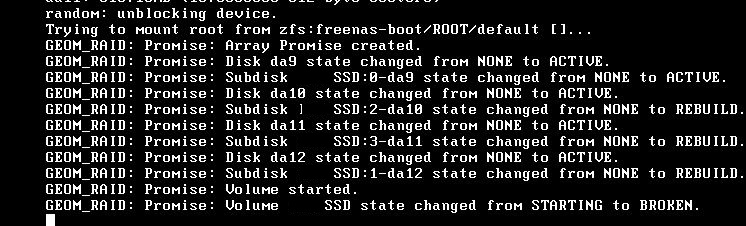

To help a little, I was able to grab a screenshot of the FreeNAS Server booting and I did notice the raid name from the storage spaces get picked up when it booted up.
(I did modify the image just to hide part of the Raid name)
I did not think too much of this when I started since I figured that creating the Volume, it would obliterate anything on the disks. How WRONG I was.
