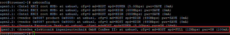

I use TrueNAS Core 13 and would like to use ioBroker in a jail there. For this I bought the Conbee II stick for Zigbee support.
ioBroker is running fine. However, I do not manage to pass the USB stick to the jail.
Via the shell of TrueNAS I can see that the stick was recognized.
In the jail I have already made the following settings:
devfs_ruleset = 2
allow_mount = enabled
allow_mount_devfs = enabled
enforce_statfs = 1
But unfortunately I have no access to the stick inside the jail.
Inside the jail I also can't issue a command to query the USB devices (e.g. usbconfig). There comes an error that I don't have the permissions. Even if I execute this as root.
Did I forget something or do I have to set any permissions?
