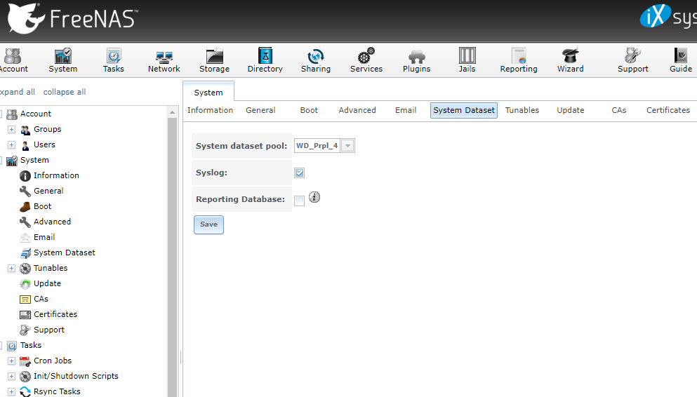

I could not find a way to import the pool successfully. I tried this "System Dataset" - "System dataset pool:"
But I got a "middleware" error ??? So... (continued under image)...

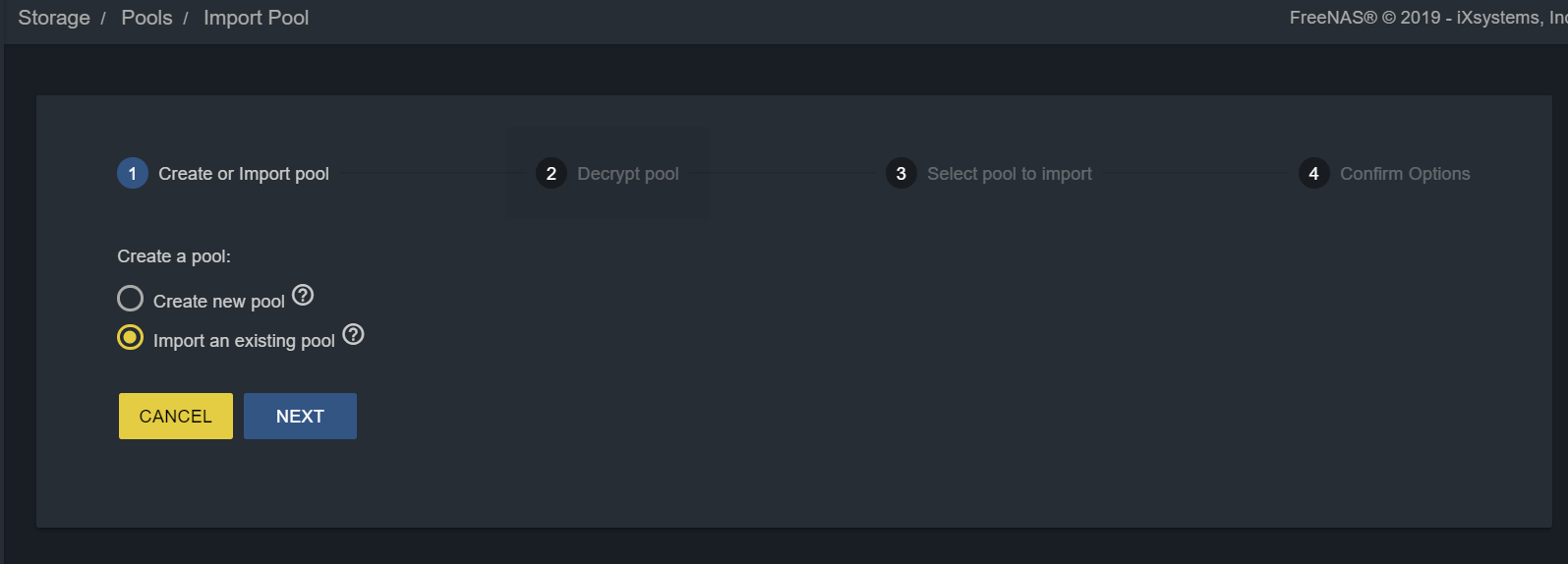

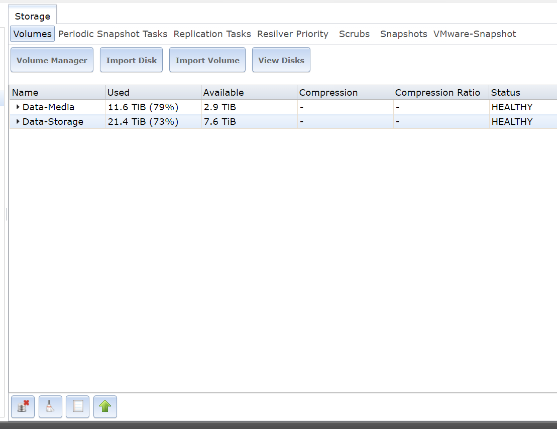

If you don't have the config, and this would be a complete new installation, you can import the pool, best done via GUI under Storage>Pools (which assuming are your datasets)>add>follow onscreen as per snip attached. Through the process DO NOT click delete at all.
1. if the pool is encrypted=i have never tried this before
2. if the pool is not available or not seen= go to shell>zpool status. If your pool is healthy it will show something like below which you should be able to import. Reasons for pools not available=hardware related mostly sata cables/ports, damaged drives but hopefully you have kept yours healthy.
  pool: Data-Media
state: ONLINE
status: Some supported features are not enabled on the pool. The pool can
        still be used, but some features are unavailable.
  scan: resilvered 56K in 0 days 00:00:02 with 0 errors on Thu Oct 17 00:17:09 2                                                                                                                                                             019
config:
        NAME                                            STATE     READ WRITE CKS                                                                                                                                                             UM
        Data-Media                                      ONLINE       0     0                                                                                                                                                                  0
          raidz1-0                                      ONLINE       0     0                                                                                                                                                                  0
            gptid/151f2837-e61d-11e7-a41a-086266295468  ONLINE       0     0                                                                                                                                                                  0
            gptid/bb0c2d26-e5db-11e7-b7ed-086266295468  ONLINE       0     0                                                                                                                                                                  0
            gptid/b70cb8cd-e4de-11e7-b58d-086266295468  ONLINE       0     0                                                                                                                                                                  0
            gptid/b84b6866-e4de-11e7-b58d-086266295468  ONLINE       0     0                                                                                                                                                                  0
errors: No known data errors

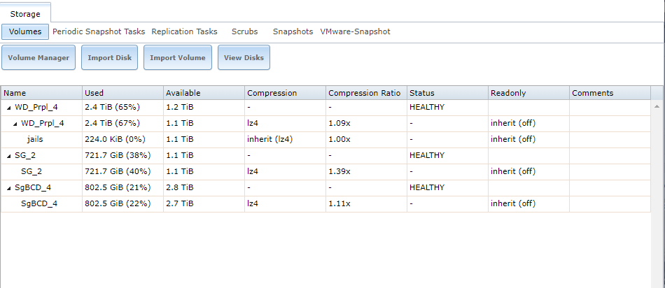

Version 9.10 must be missing the pools button in GUI under storage... (I looked through all these menus)

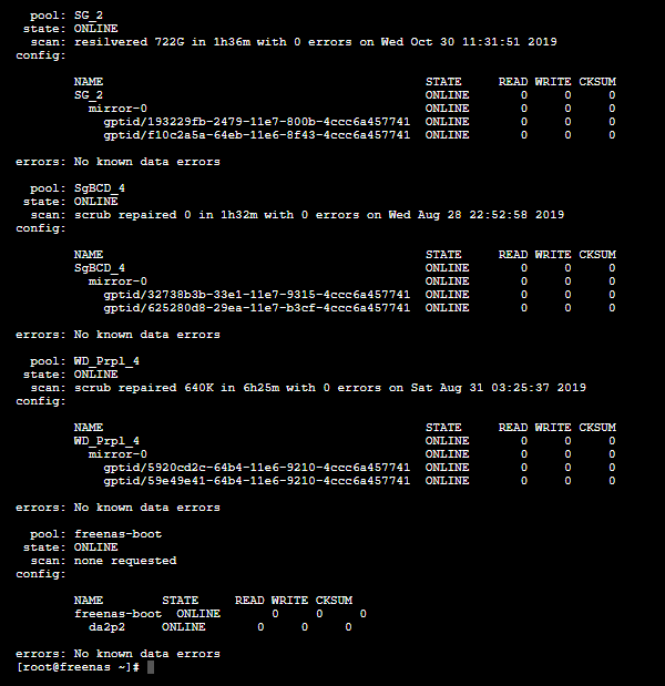

I have run zpool status under shell and ran another long smartctl on one of the WD_Prpl_4 drives last night (I think It is failing, getting errors... )
This is the zpool status display.
i have posted 11.2U6 in legacy UI, it's the same as yours (note there still buttons at bottom). The Volumes are the pools. i have 2 pools/volume and you have 3 pools/volume. Import volume button is the one used to import pools.
your pools are all in mirror, for the failing drive just need to replace it (follow the manual strictly, please)
