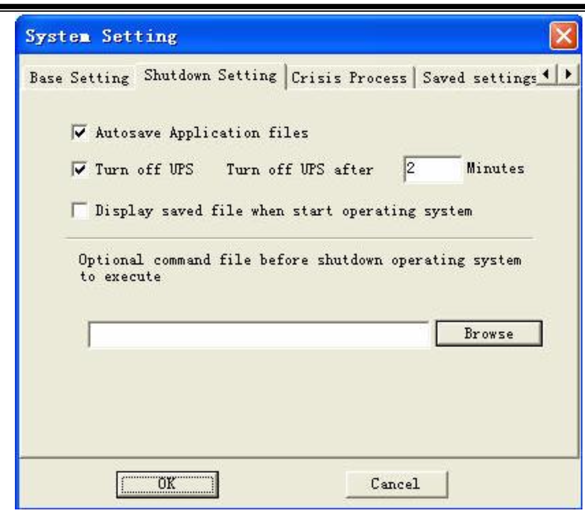

2. Another option is to connect the UPS to another client (WIndows/Linux) and install the PowerManagerII software.
According to the user manual, the UPS can then be monitored via a network.
Simultaneously, the user can remotely monitor the UPS via a network and manage the power system more effectively.
Monitoring UPS remotely via TCPIP or Internet.
What is not clear is if the PowerManagerII software supports standard UPS Master/Slave network monitoring which is compatible with NUT.
3. The last option is to connect the UPS to another client (Windows/Linux) with the PowerManagerII software and set up a script to send remote commands to TrueNAS to shutdown the system. A Raspberry PI running Raspbian with the PowerManagerII linux drivers and mashing together NUT to set up the UPS as a "UPS Master" is theoretically possible. It all depends on your skill set and motivation.
