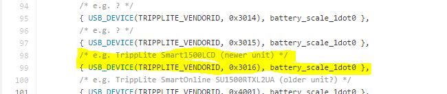

So, I have done a lot of research on my UPS issue and I haven't been able to resolve it. What it comes down to is the UPS is supported by NUT, but that version of NUT has yet to be compiled into FreeNAS. This particular UPS requires protocol 3016 with the usbhid-ups driver. Highest protocol I can find within FreeNAS is 3015.
My question is two-part. Is there any work around to changing the protocol that usbhid-ups uses, and if so how do I do it? The other part; are there any intentions on upgrading NUT in a future release of FreeNAS? I don't recall exactly what release of NUT this was included in, but can locate that information again if needed.
EDIT: I found this on github: trippLite3016.JPG
https://github.com/networkupstools/nut/blob/master/drivers/tripplite-hid.c
I'd put in a feature request for an updated NUT.

I could put in a feature request, but it may already be included. From what I have found today with some more searching, protocol 3016 was added to NUT with version 2.7.1. I don't know what version FreeNAS 9.3 is using. While I obviously would like to see my UPS working with FreeNAS, I may be just as interested in figuring out how NUT integrates with FreeNAS. And by that I mean how is NUT compiled into FreeNAS? Where should I begin to look on github to figure that out?

Thanks for that. I can get around linux okay when I need to but I'm fairly new to freeBSD. The same version is on my system, 2.7.2_6. This means protocol 3016 should be included within tripplite-hid.c within NUT. So this leads me to believe that there is at least 1 UPS device (the one I need) within NUT 2.7.2 that have not been completely added to FreeNAS 9.3.

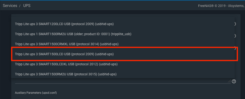

the NUT docs state that the SMART1500LCD USB (protocol 2009) is supported by the usbhid-ups driver. So I would pick one that is nearest in terms of model number and see how that goes. Just because it's not listed explicitly doesn't necessarily mean you can't use it with FreeNAS. Indeed that (almost) exact model is in the drop-down of 11.2-U3 which is what I'm running.
Yeah, did that. I was unable to get it to work. Actually tried all of the different protocol numbers for the smart1500 I could find. UPS service finds the UPS, it just can't communicate with it.
Looks like Protocol 3016 is the key, but it isn't listed in the dropdown menu. Also I couldn't find the driver.list file mentioned in posts above to add it, and it didn't work adding the protocol number to ups.conf.
