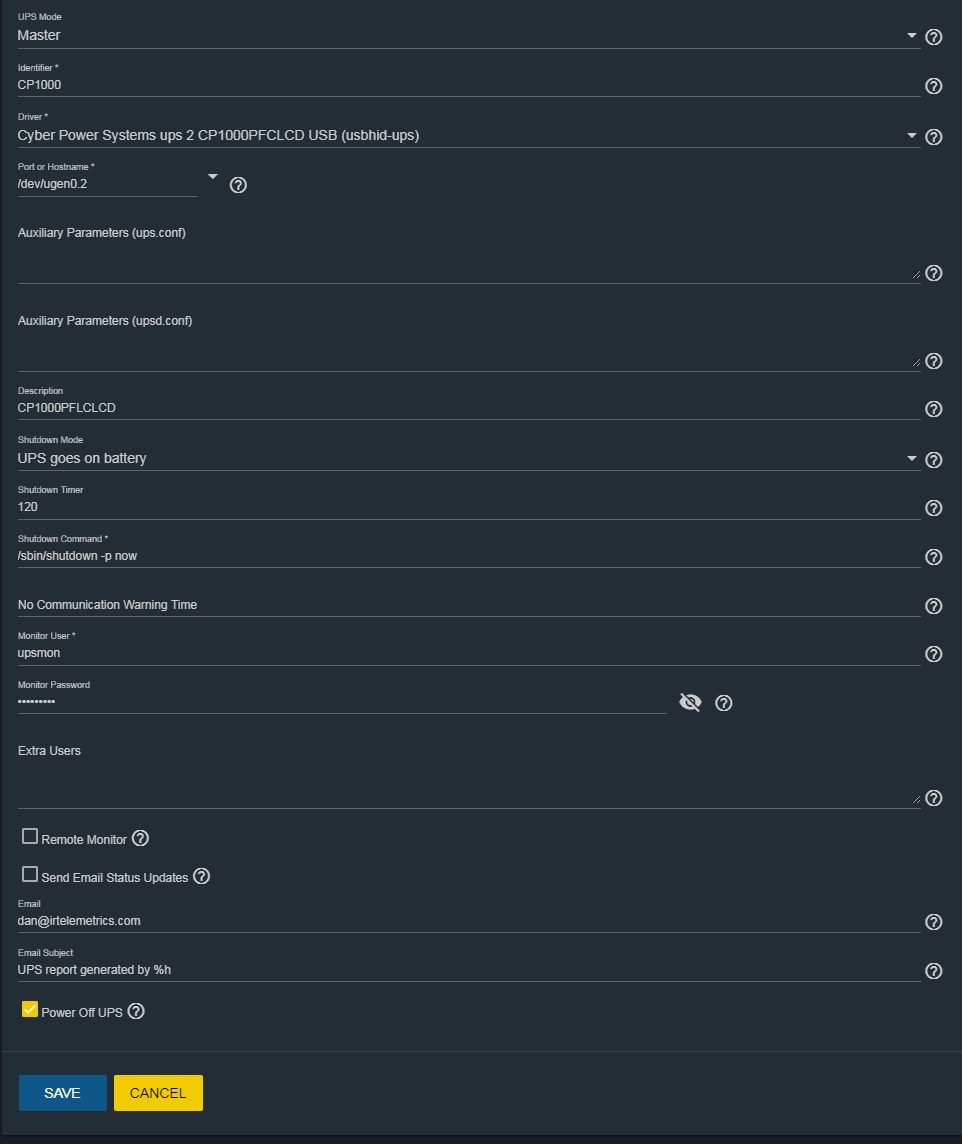

Hi All,
Installed a CP1000PFCLCD today. Freenas seems to talk to it just fine, at least NUT is reporting it can communicate.
Issuing a upsmon -c fsd, causes freenas to shut down as expected.
However, pulling the plug on the UPS results in the following messages on the console.
May 23 18:49:35 FreeNAS upsmon[5148]: UPS CP1000 on battery
May 23 18:51:35 FreeNAS upssched-cmd: Shutdown not initiated as ups.status indicates CP1000 is ONLINE (OL)
At which point I plugged it back in again.

Here's the UPS settings from upsc:
battery.charge: 89
battery.charge.low: 10
battery.charge.warning: 20
battery.mfr.date: CPS

So, I must be missing something dumb. How do I get this UPS to actually issue a shutdown freenas?
Note, I tried setting the ups.conf offdelay ondelay values previously, which resulted in the UPS powering down the computer after the offdelay time without actually having freenas shut down!!! It appears the ups was issued a shutdown command and did as it was told, however freenas didn't shut down when requested because that ups.status indicates the UPS is still one line, even though it's power cord is unplugged...
Again, This shouldn't be this hard.

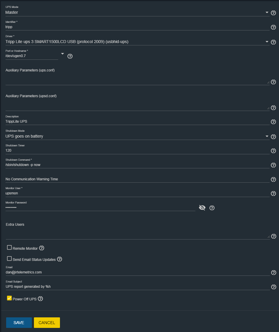

However, Just some information to consider. I have discovered (the hard way) that not all UPS's are the same. On the 4th of July we had a lightning hit. The ONLY things that died were the UPS on my FreeNAS server and the main board of that FreeNAS server. The PC power supply between them was OK. I strongly suspect the path of damage was the USB cable, caused by a poorly designed UPS. Network is done with dielectric fiber, so no lightning there. I currently do not have a UPS connection to my FreeNAS server because of this, and the fact that FreeNAS won't talk to the TWO ups's I've purchased for this application thus far anyway, despite both of the UPS's being on the NUT list.
If you find one that works, please report back. I've yet to identify a good UPS that actually works correctly with FreeNAS. Even then, I question how safe a USB connection really is if lightning is a concern.

Last summer we were hit on fathers day, this summer it was 4th of July. So far the Tripplite UPS's have been performing well, and was the intended UPS for the freenas box also except it isn't supported in NUT (despite being on the list). Ended up with a CyberPower, and it didn't do it's job... CyberPower did replace the UPS.
I was in the process of filing a connected coverage claim with CyberPower when Supermicro just went ahead and replaced the board I had sent in for diagnosis. In general, I was very displeased with CyberPower. Supermicro on the other hand was great, and I recommend Supermicro to anyone who will listen. We just had them quote and build a new ESXi server, they were amazing to work with and had great prices.
Anyway, if you do verify your UPS works please let us know.
