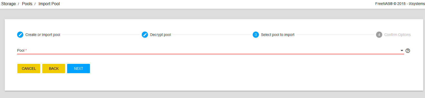

I've fresh installed 11.2 stable and tried to import my 8T Zpool (pictures, backups, life)

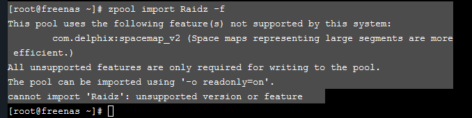

Got this:
I'm guessing this happened during one of the pool upgrades.
Able to mount in readonly mode but don't have the storage to move all the data and back again.
Was wondering - Can I add spacemap_v2 to version 11.2 stable?

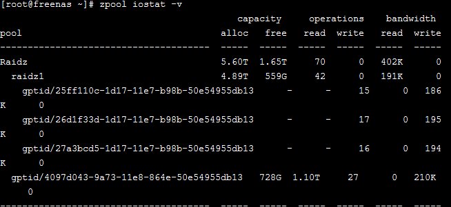

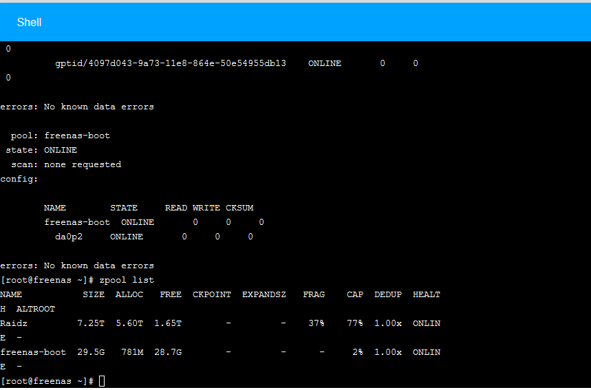

It seems the pool is ok (fheww):

Sorry you had trouble. Please submit a bug report.
I have seen this before. The revision of the ZFS used in the nightly is newer than the stable. You will need to use the nightly.

Ok, sorry for the mess.
I've run
zpool export Raidz
And then proceeded to import from UI which worked!
More over, I think I know what was the problem - I had some plugins in iocage which worked with 11.2, and i think along the way moving to 11.3 didn't bode well for them coexistence wise.
Thanks again for all the help.

you need to export it via the cli and import it using the gui.
