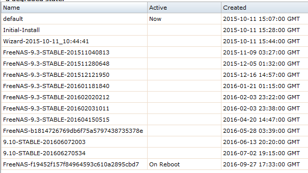

homelabC
Sep 30, 2016
Tried to do the update and system appears to update but there was no reboot. The "Boot" tab indicated that the system was running 9.10.1 and so I selected 9.10.1-U1 t make it active and rebooted but now the system starts and halts in "grub rescue" stating an "error: file 'normal.mod' not found. Not sure how to proceed.
Same issue here. There appears to be a bug thread referencing similar/same issue here: https://bugs.freenas.org/issues/17790
