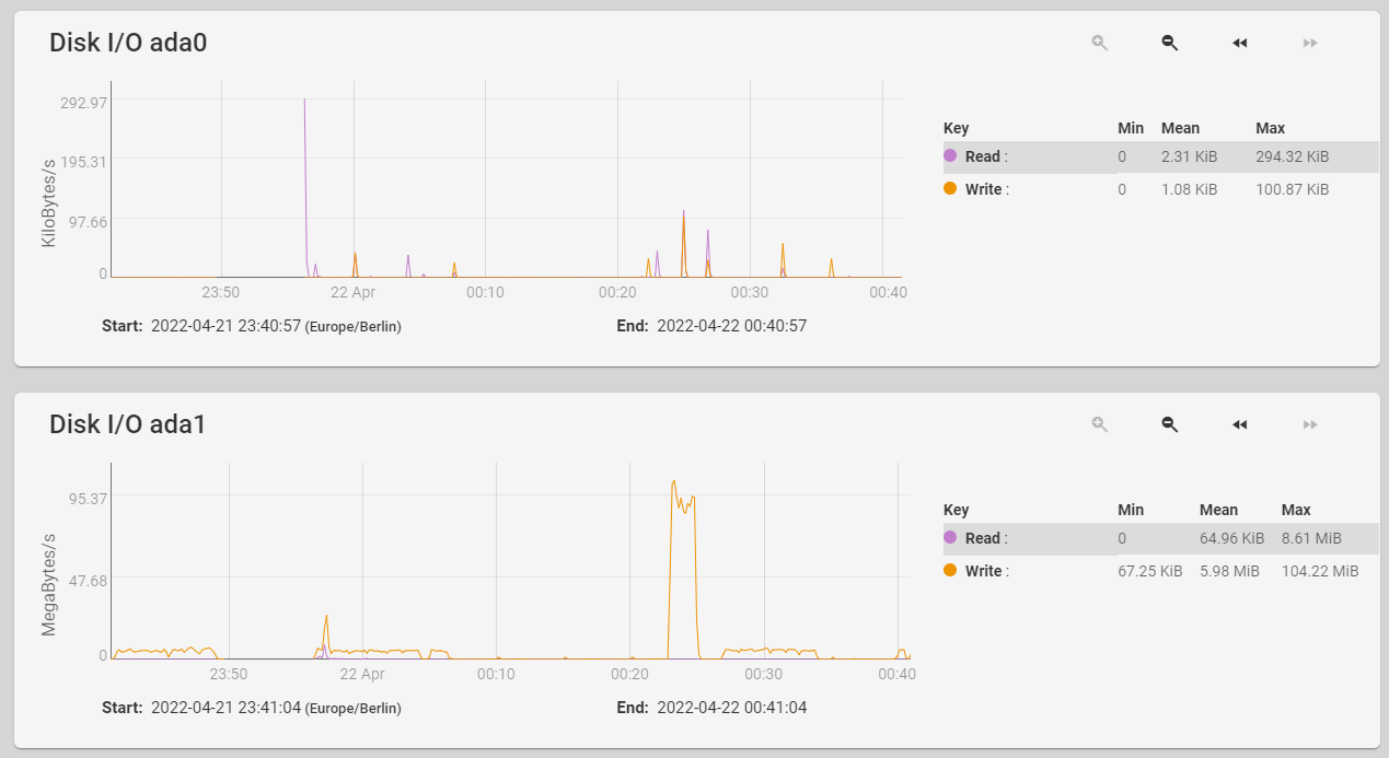

Now I removed unused ada3 and installed 12-U8.1 via USB-Stick.
Now I have 5-10 MB/s write and read speed. No fun at all.
the peak around 95 MB/s is a fio test
Now, this morning, the speed dropped to 3 MB/s
