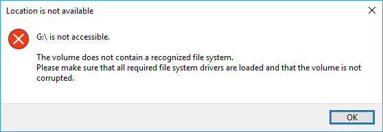

Downloaded 11.2 (link in user guide (https://download.freenas.org/latest/) doesn't work) and used RUFUS to create a bootable USB stick. However, what I wound up with is a GPT, even though I asked for MBR/BIOS. A friend had the same experience. Created other bootable USBs from .isos with no problems, so the problem appears to be related to the FreeNAS download (FreeNAS-11.2-RELEASE-U1.iso). What am I missing?

Tried Etcher. Not sure what I've got yet, but Windows said:
Apr 23, 2017
30
Here's what I've got; consistent with RUFUS, fwiw:
UFS, GPT, or whatever, it won't boot.
Apr 23, 2017
30
Apr 23, 2017
30
I found from the RUFUS author that this particular ISO image is a hybrid (whatever that means), and is not supported by RUFUS, but you can write it as a DD image. It's also not even acknowledged as a "valid ISO" by Microsoft, so I think the FreeNAS folks has some 'splainin' to do. I haven't found a way to write a DD image in RUFUS either. I think I'm going to give up and use a CD or DVD.
