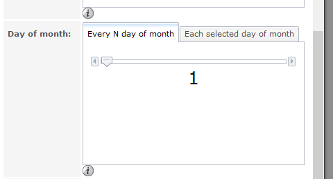

Select all days under Day of Month -> Each selected day of the month [select each day as any day could be a Friday depending on the year and month], and;
That should work, but you can just use the "Every N day of month" and set it to 1 like this:
That will have it run every day, as long as it is a selected day under your fourth point.
At the moment, I'm struggling, a little bit, how the second bullet point and fourth bullet point inter-relate, if at all.
You have a sequence of conditions that all need to be true. If it is a selected hour, and it is a selected day, and it is a selected month and if it is a selected day, then the test will run. These conditions give you a lot of freedom to choose when a test runs and it sounds like you are working it correctly.
