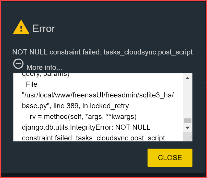

I wanted to backup my FreeNAS (11.2 Release) to Backblaze. I followed this article : Backing up my FreeNAS to Backblaze B2
(https://blog.briancmoses.com/2018/08/backing-up-my-freenas-to-backblaze-b2.html?r=related )
I was able to set up a Backblaze B2 cloud credentials on FreeNAS OK and then followed it up by trying to set up a Cloud Sync Task. It failed with a "NOT NULL constraint error"
I logged a bug https://redmine.ixsystems.com/issues/64395 yesterday with the relevant traceback info.
Has anybody set up syncing to Backblaze without issues? I know my FreeNAS is talking to Backblaze as it was able to correctly retrieve the bucket name. I tried with encryption and without, but still no luck. Any help is greatly appreciated.
