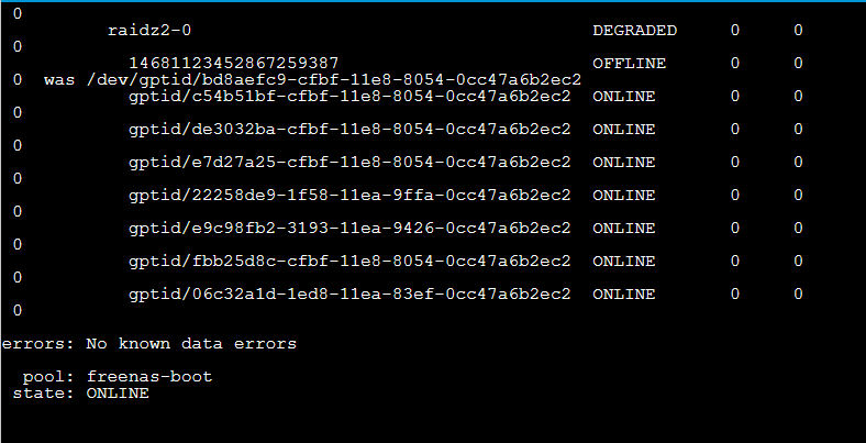

nemo1478
May 5, 2015
43
So I googled a command and here is the result.
9,700
That looks like the output from zpool status
Not so helpful here...
Unless you wanted to use it to rule out the rawuuids from each of the partitions you will find with gpart list

nemo1478
May 5, 2015
43
I'm still not sure how to identify the new disk from the output of the 'gpart list' command. da0-da8 is still only 9 disks (7 pool + 2 boot). So the new disk is still missing? Am I correct?
9,700
Sounds like it may be... are you sure it's correctly connected? Maybe we need to see the output from dmesg to figure out if there's something preventing it from being presented.
If you take the rawuuid of daXp2 for each of the disks, you should find it in your zpool status somewhere.
Since the numbers match up, we can save ourselves the pain of doing that.

nemo1478
May 5, 2015
43
[/QUOTE]
[/QUOTE]
I don't understand what you mean by this?
nemo1478
May 5, 2015
43
Good news!!! I replaced the drive again for the 5th time, this time with a WD drive instead of all the Seagate's that I tried before. The member disk showed up in the GUI and I was able to do the replacement. Resilvering is in progress!
I have no idea what made the difference since this WD is also a spare from the previous build that I mentioned earlier and it's not empty plus the other 4 Seagate's are all working drives.
The new disk is showing up under Storage - Disks as da9 and it's status is unused.
Thank you so much sretalla for your patience, expertise and assistance. It was good to know that I could reach out to someone for help.
9,700
Looks like you had a problem with the seagate disks: you had this in the dmesg a whole heap of times when you had one connected:
(probe3:mps0:0:2:0): INQUIRY. CDB: 12 00 00 00 24 00 length 36 SMID 262terminated ioc 804b loginfo 31111000 scsi 0 state c xfer 0
(probe3:mps0:0:2:0): CAM status: CCB request completed with an error
(probe3:mps0:0:2:0): Retrying command
That would explain why it was not visible to the OS, the controller couldn't get it to respond.
