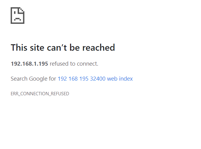

Hope someone whos a bit more of a plex guru can come to my rescue, Today I updated plex via shell commands PKG Update & PKG Update - Y which has always worked in the past where the update button on the FreeNAS gui never has. However this time something has some wrong whenever I try to load the server I get the following error. I have of course tried to reboot and tinker with the ip settings but cant work out what has gone wrong.
Maybe its possible to roll back to a previous version or snapshot?
Thanks!

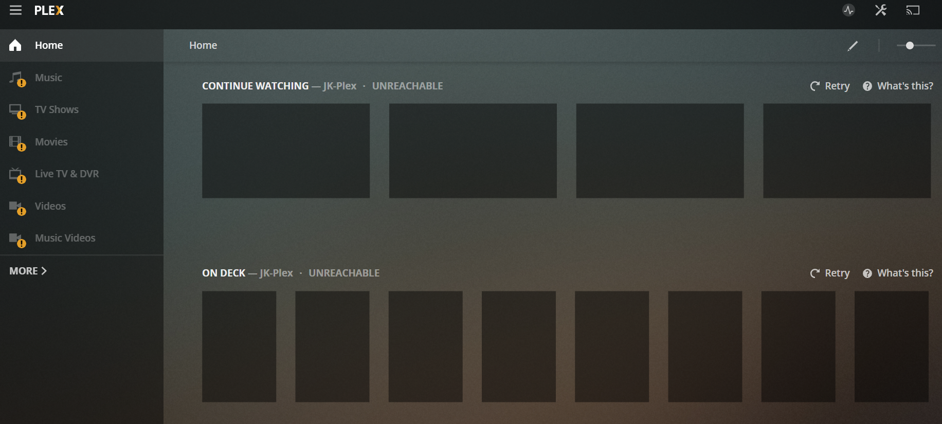

Update now works by manually starting the service via services plexmediaserver onestart however the server is unreachable. Is there a way to manually ammend IP settings via shell to ensure these are correct?
