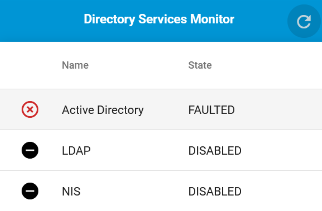

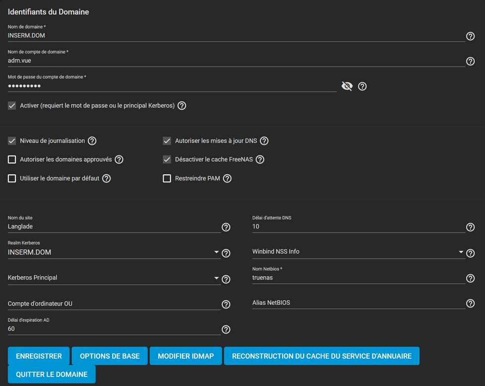

I cannot integrate AD on my TrueNAS. I am on the latest version of TrueNAS Core, hosted on a Debian 11 VM on Proxmox.

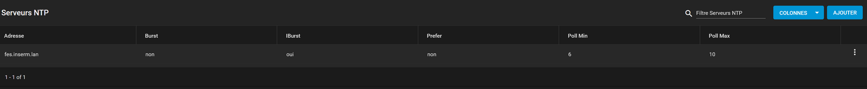

  • I setup a connection to our company's NTP server to sync time in preparation for our AD:

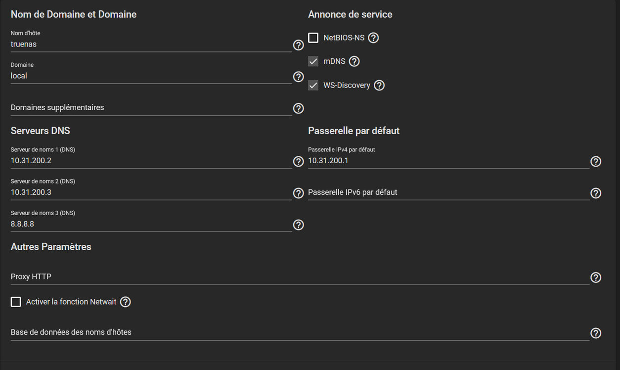

  • I configured the right DNS settings, which checks out because the ping to our NTP server name resolves correctly in Shell:
  • I put in my AD credentials (but am not sure of the format):
  • You can see here that a "Leave the domain" option is available on the bottom left, however I am not joined to the domain:

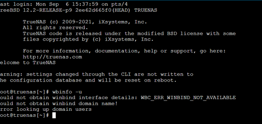

  • and my wbinfo shows that :

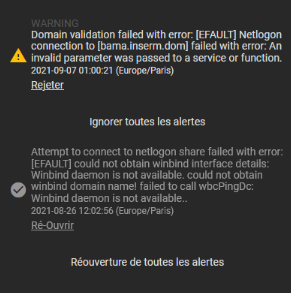

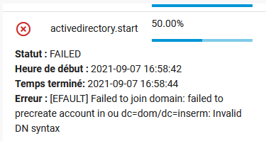

  • These are the alerts I'm getting:

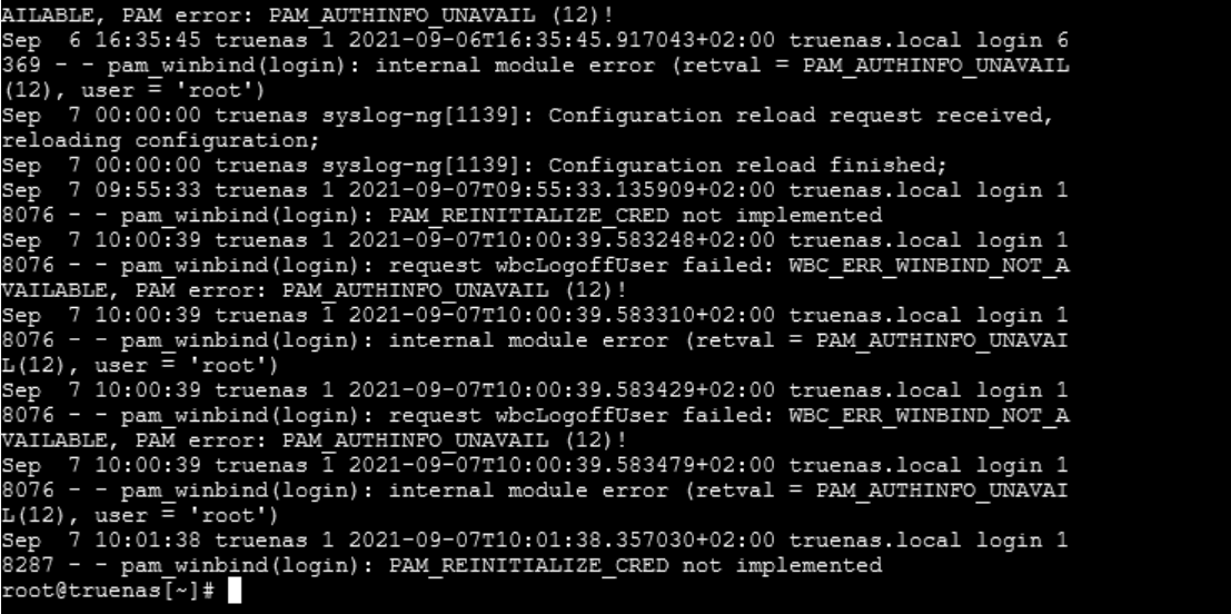

  • And my /var/log/messages outputs this when I try to connect to my AD:
  • So my question is: what am I doing wrong? Is my failure to integrate AD caused by a configuration error, or are my credentials wrong? I have setup AD on other apps and have never had trouble before.
Edit: Noticed this alert had more details I didn't include in my original post:

What AD servers are you using?
Windows version
or SAMBA?
I am just guessing here
NugentS
Apr 16, 2020
2,945
Try again with just the basic settings, remove any advanced settings you may have applied
