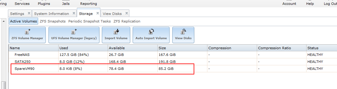

When I look in FreeNas web GUI, I see Used: 8.0 KiB(8%), Available: 78.4 GiB, Size: 85.2 GiB.

Below is a screen capture of what I see on the Storage tab.

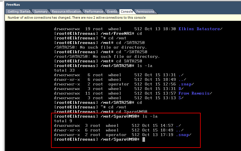

I was able to get and look at the drive. From what I see, there is nothing in SpareVM90 (screen capture below)
Is that what you think also? If so I will remove any other data as soon s possible and get FreeNas out of my virtual environment.

Unfortunately there is no way to tell what has happened. But if you can't see the files via the console freeNAS probably can't serve them up via cifs.
I only know with low resources strange things happen. But don't have any use for or significant experience with UFS. Whether you want to try and find that data on another OS is up to you. Looks like it's gone. Occasionally we see people create a dataset over existing files... and they won't show even though they are there.
