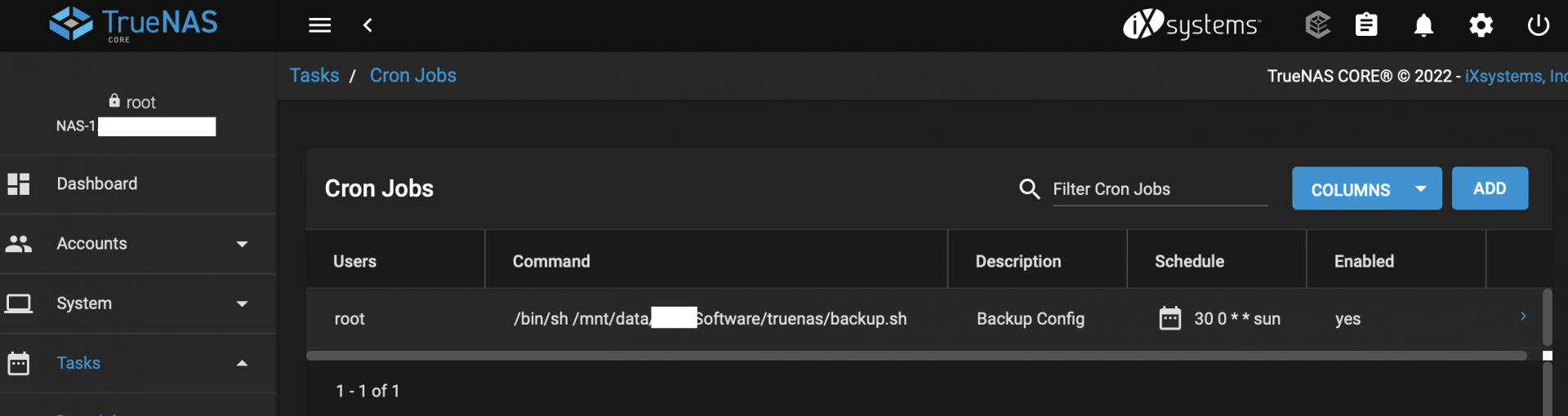

3. What does your CRON entry look like?
4. You may have to prefix the rsync command with the full path
which rsync
/usr/local/bin/rsync

1. Does the script contain the bash shebang header?
2. Did you add execute permission to the script?
3. What does your CRON entry look like? View attachment 56932
"#!/bin/sh"
I don't truly understand this thing but there it is, thank you!

/usr/local/bin is not in cron's default search path.

No. #!/bin/sh tells the system "this is an executable script and please feed the contents of the script to the interpreter /bin/sh for execution." The script is written in the "sh" programming language so you need to feed it to that interpreter. You can start scripts with #!/usr/local/bin/perl or #!/usr/local/bin/python if they are written in the Perl or Python programming languages, respectively. I'm simplifying a little bit (for the pro's: let's skip "env" here for simplicity), but that's essentially "it".
The search path for executables is part of a process' environment. And it is documented behavior that cron runs with a path set to /usr/bin:/bin - which are the directories where system binaries are kept. /usr/local/bin is not part of FreeBSD proper but the place where additional 3rd party software lives. So you need to write that into your shell scripts explicitly or configure a path like /usr/local/bin:/usr/bin:/bin in your crontab. Unfortunately the latter method is not available in the TrueNAS UI, although it is in plain FreeBSD on the command line.
