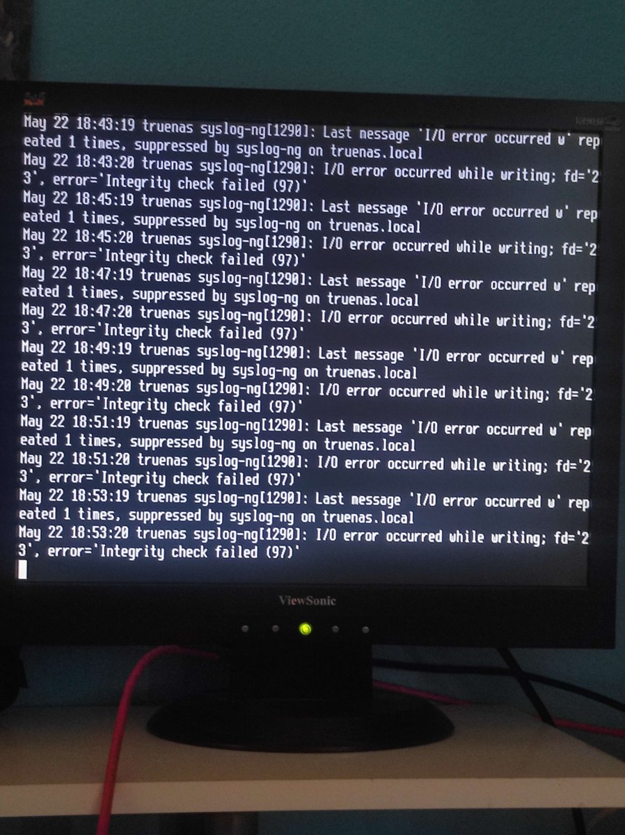

I connect a VGA monitor to the TrueNAS machine and these errors show up every 2 minutes:
"May 22 18:53:19 truenas syslog-nd(1290): Last message 'I/O error occurred w' repeated 1 times, suppressed by syslog-nd on truenas.local
May 22 18:53:20 truenas syslog-nd(1290): I/O error occurred while writing; fd='23', error='Integrity check failed (97)'"
The machine seems to be working fine, with SMB access and sync thing jail working. However, this error worries me.
What is it?

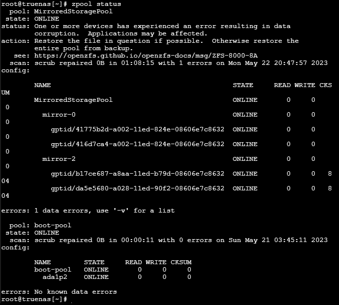

  2. Show output of zpool status
How are your HDDs connected? USB?

Here is zpool status:

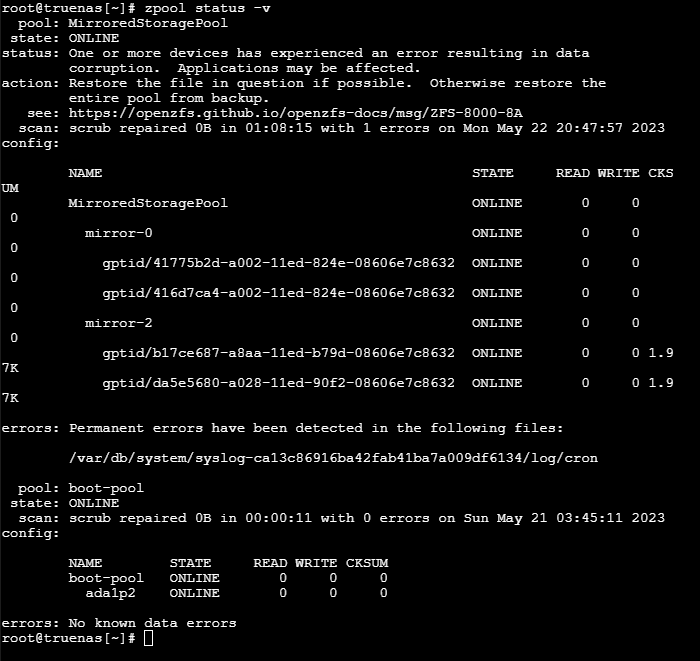

You likely will need a backup. Run a scrub on your data pool, then zpool status -v to identify the corrupted data.
In an attempt to fix this issue I ran a scrub on the pool yesterday before making this post.
Here is the output of zpool status -v

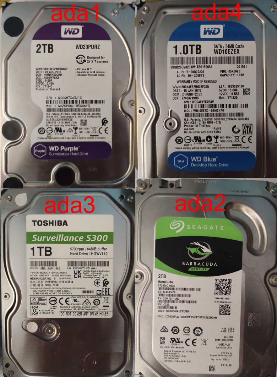

I removed all drives and inserted them back in the desktop, reseated all cables and took a picture of each drive (I saved the S/N of each adaX before shutting down to identify them here):
However, upon boot up, the pool was offline and the 2x 1TB disks were missing, these two disks are being powered by a Molex to SATA power adapter (since my PSU only has 3 SATA power connectors). After this I shut the system down, and used a different Molex connector to power the 2x 1TB drives, the pool is now back online but "unhealthy".

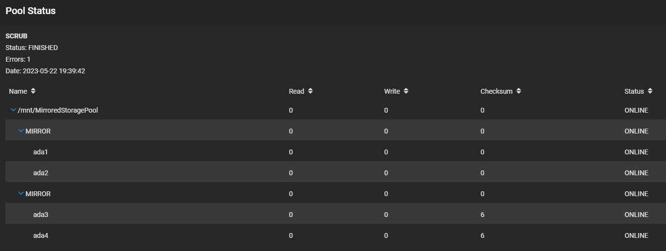

Perhaps relevant to mention that these 2x 1TB disks are the disks throwing checksum errors:
The checksum errors seem to increase every time that I/O syslog-nd error appears on the VGA output of TrueNAS.
