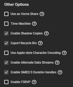

I have TrueNAS 12.0-U3, the Option is at:
"Sharing --> Windows Shares (SMB) --> klick three Dots next to your Share, Edit --> Advanced Options --> Other Options"
Tick the Box next to "Export Recycle Bin" and klick "SAVE".
I also had to restart the SMB Service for it to take effect

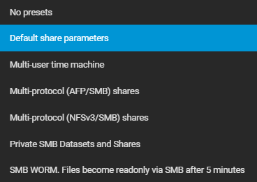

Hi, anodos
Yes that was the problem.
Not immediately obvious when looking at the options on the black background. I looked at the currently highlighted option (assuming this was the top most item) then down the list initially ignoring the "No Presets".
Many thanks to all who replied
PDM
Dec 17, 2011
24
Have you switch the share configuration preset to "NO_PRESET"?
I only noticed this with a new dataset SMB. Had to go and change all my shares to "NO PRESET" so I could enable the .recycle bin again.

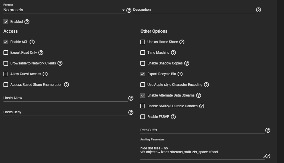

Sorry to resurrect an older thread, but I just noticed that my .recycle is not working as well on my SMB shares. I assume this died when I upgraded to TrueNas and I didn't notice. These are my current settings. Any suggestions?
Gilley7997
Feb 23, 2015
42
You have hard-coded VFS objects that prevent it from working.
OKay, so let me ask the next stupid question. I'm pretty sure that those settings came from a suggestion here at some point years ago. I don't exactly know what those are doing.
What should be done to enable it again? What is the harm to removing these?
anodos
Sambassador
Mar 6, 2014
9,554
You can add a # character in front of the line, save, and restart SMB. That particular line is quite incorrect anyway (out of order and has two ACL modules enabled).
