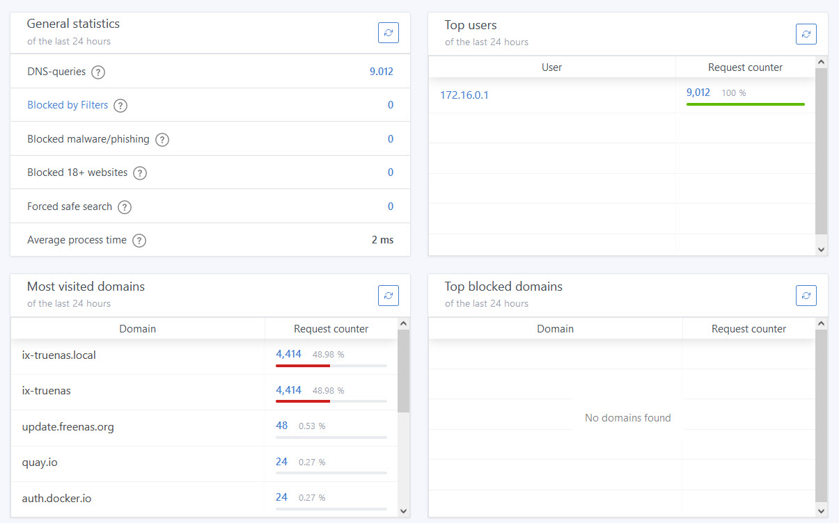

The truenas scale I just installed today, I set up the adguardhome dns server for truenas scale, and I found that there are a lot of dns requests on the adguardhome's dashboard.
I found that the same issue is being discussed here:
So you're running this under K8s on TrueNAS, and you're seeing what is apparently a normal K8s behaviour.
Have you tried telling Adguard to ignore it?

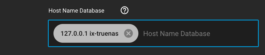

In nightlies I've enabled nscd for hosts so in theory you might see less of these requests (due to negative cache).
This name is used in apps to get to the kube-api-server. On my machine ix-truenas was not resolvable for some reason, but adding it to the hostname list allowed me to get logs and shells again.
So the fact that this request is making it off the machine is a bug in that the machine has forgotten it's own host alias.

I meant adding it to the field under Network tab called Host Name Database. This will persist the value in /etc/hosts across system reboots

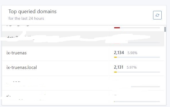

Sorry, this is kind of old, but I just noticed that TrueNAS Scale is the most active DNS client on our LAN with these queries sending a new query every few seconds. Adding the entry above doesn't seem to make a difference.

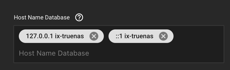

At the moment I cannot say whether this completely solves the problem, but I have added a second entry for IPv6:
EDIT: For me these entries solve the problem, there are no further entries in the AdGuard log. Thanks @ksimm1
