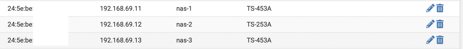

You can set up DHCP static reservations for DHCP clients.
Example:

I don't think that will matter if it's a reserved DHCP address, I believe the server has a bug where it won't listen to the sub flag telling it "this is your DNS server"
