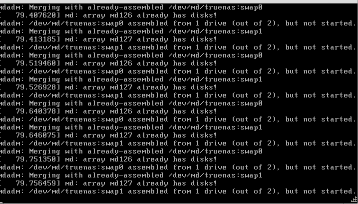

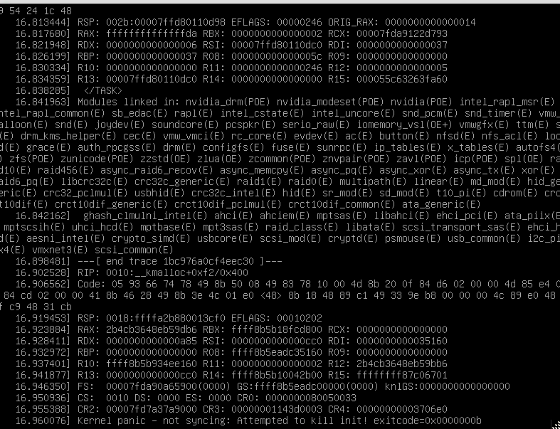

So i've tried to upgrade to latest release from 22.02 to 22.12 and it went well apart of not able to start plex.
I've decided i'll activate older boot kernel. But plex still didn't wanted to work...
so i've restored configuration on older variant.
and now it doesn't want to boot at all..
Plex issue was probably the new host path validation check.... in the release notes.

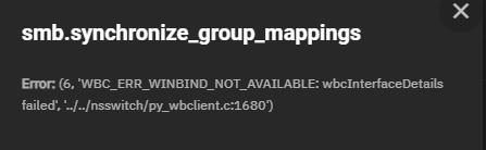

After couple iteration or trying different versions of Truenas with uploaded config file i've managed to boot original installation and with host patch=false it works now. kubernetes is not functional. It did't want to start at all.
My main issue is that now it seems that AD credential doesn't work. even though
looks ok
I can access shares with local credentials.
with older 22.02.2 it worked without any issues.
and there is something like this:
