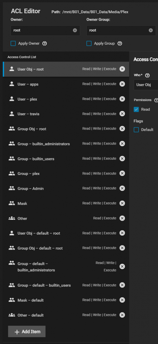

So i just updated to SCALE-22.12.2 and plex couldn't find my videos i checked the permissions and everything was still there.
I created a plex user a while back
admin@truenas[~]$ id plex
uid=1000(plex) gid=1000(plex) groups=1000(plex),4000(Admin),545(builtin_users)
and everything was fine it could read and write no issues. Today i had to give read and write access to other. I'm not sure if the plex app UID and GID changed. but I'd love to change them back to 1000 so i can get rid of other again.

How would i go about changing the app back?
