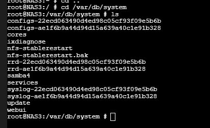

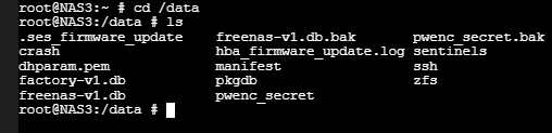

2. Depending on how you got to where you are, the configuration file may still be on your system, as there is an automatic daily backup.
The config db file is named freenas-v1.db and is located at: /data:
However, if that directory is located on a boot device that is failed, we can't get it there.
There is a copy that is automatically saved for you in the system dataset, if the system dataset is on the storage pool.
If you created a datapool, the system dataset is automatically moved to it (assuming that you didn't move it back).
If you think you still have a datapool, make a fresh install of TrueNAS on a new boot media, and import the storage pool, you should find the previous config db at this path: /var/db/system/ plus another directory that will be named configs-****random_characters****.
This is what one of mine mine looks like:
If you can get that far, come back and tell us and we can guide you to the next steps to get hold of your contig file and reload it.
