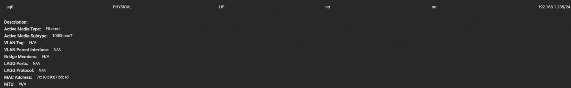

Have tried setting interface on truenas to static, disabling hardware offloading, trying a different interface(onboard ethernet that has worked before).

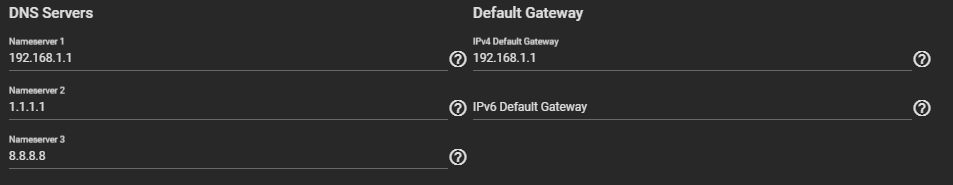

Have verified that setting in global config are correct about 10 times

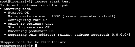

Everything has been running fine until. I use DHCP for jails, then set statics in my firewall (Unifi Cloud Gateway Pro). Now jails won't start due to the error
"Acquiring DHCP Address: FAILED, Address received: 0.0.0.0/8."
The Truenas does have a 10gb nic, but i have tried the onboard also with the same issue.

DNS (for testing purposes): 1.1.1.1, 8.8.8.8
