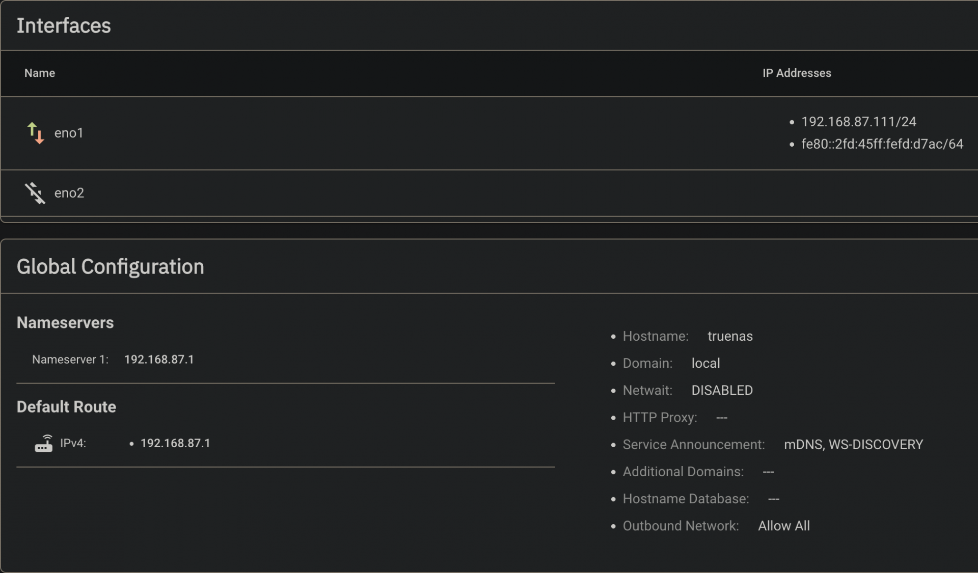

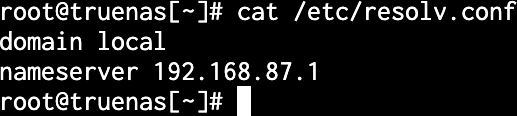

I found similar posts where most issues was solved by configuring the default ipv4 gateway, nameservers and even the /etc/resolv.conf file. I tried configuring these too but no luck.
I have manually set 8.8.8.8 as nameserver, and pointed to DHCP server/router as nameserver (as seen in picture). No difference.
