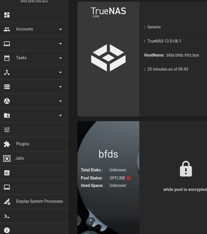

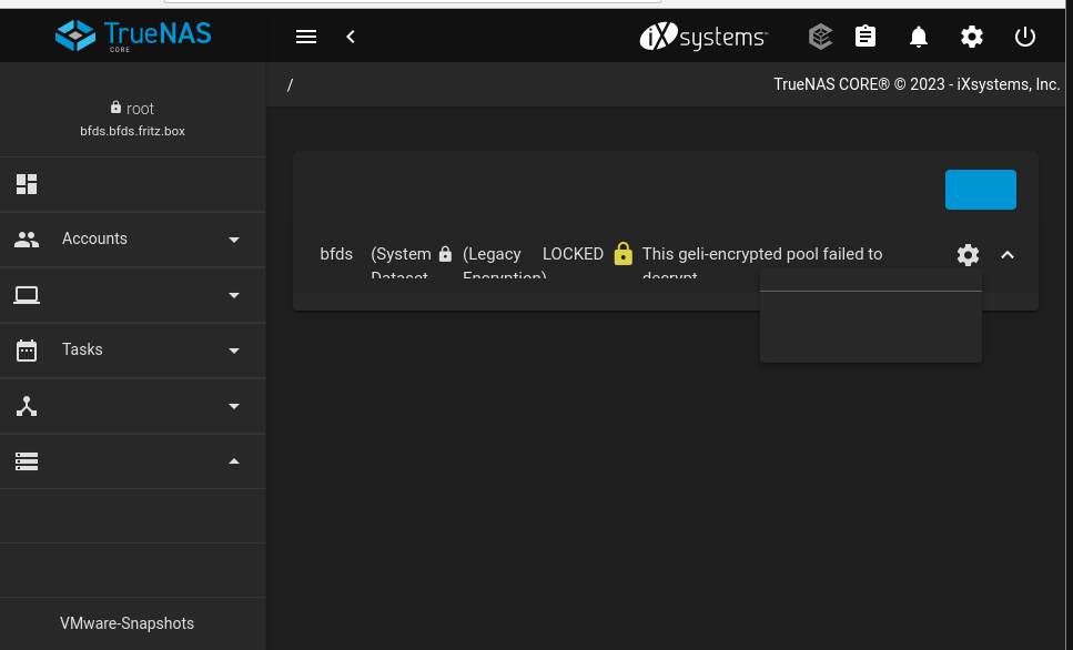

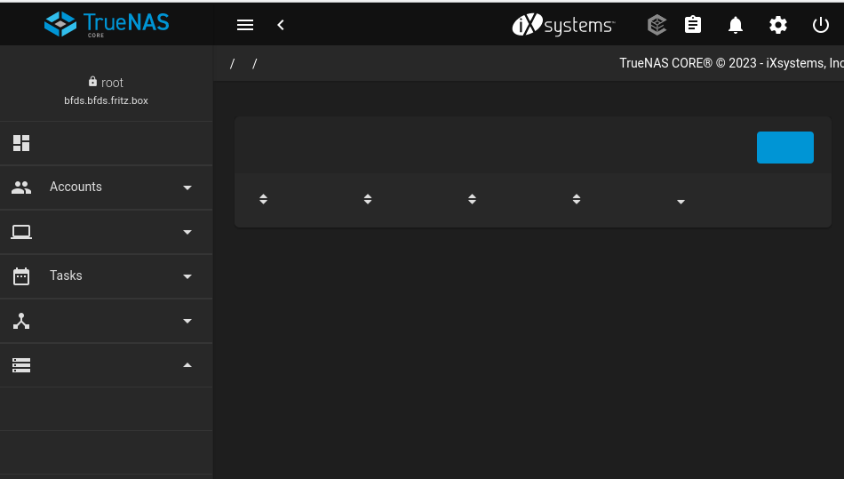

But after the initial shock, I calmed down about backing up the configuration. So I built a new drive in the server and installed TrueNAS-13.0-U6.1 from scratch. No problems here, everything looked fine (without the GELI drives of course). But after I uploaded the configuration and
no errors occurred when writing the configuration database, the user interface is broken (see screenshots). And also the GELI drives are not decrypted. Now I'm afraid for my data. Fortunately, I still have an offsite backup of my data, but hope not to need it, but that TrueNAS runs again as before.
Did you try clearing your web browser's cache?
Did you try importing the data pool and choosing "Legacy encryption" before selecting the relevant drives? (You might have to first export the "phantom" pool.)
Yes sure. But nothing changed. The same happend as a put the backup into a fresh installation of TrueNAS 12 on another drive.
I dont know why, but on the terminal I can use the encryped pool.
