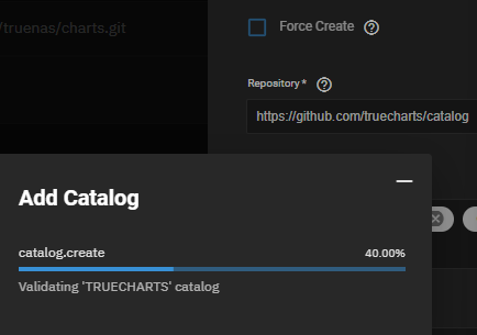

I have tried for the past couple of months to add true charts to my truenas scale. Every time I try to add it the install gets to 40% then turns off my server. I just upgraded my ram so I have 24 gigs of ram, I figured that would help with the install.
I followed the instructions from truechats site. Am I doing something wrong? Does anyone know how to see the error log?
Any help would be great!

Same problem here.
I have the catalog.create task in task manager stuck at 40%. Restarting the server did not solve the issue - any other way to kill the task and retry installing the truechart catalogs?

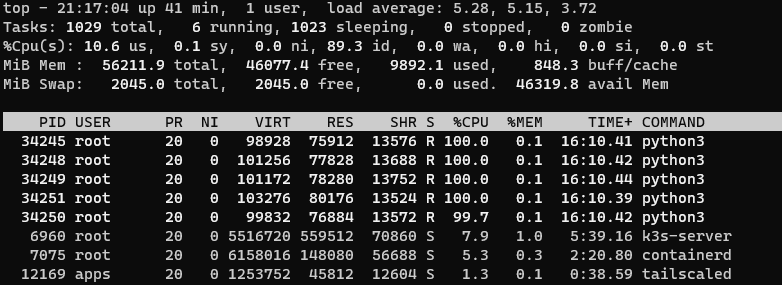

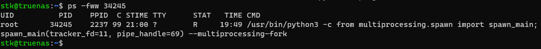

What happens is the git part of it executes, then truenas does the "Validating truecharts catalog' and everything stalls at the 40% mark. This spins up 5 python processes with command line args as below.
These 5 python processes took nearly 30 minutes of CPU time and but finally finished!
So you didn't wait long enough. I have no idea why it takes so long, but it was definitely over 20 minutes on my machine.
It will only use 5 cores and run them at 100% for 20 minutes or more. But it did finish to my surprise.
NOT WARNING PEOPLE OF THIS is a problem.
Truenas must have changed the validation algorithm to make this take so long since YouTube video claim only a few minutes.

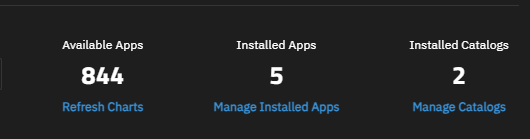

Woo hoo. My 30 minute wait to crunch the truecharts catalog paid off. 844 apps now available, up from 106
