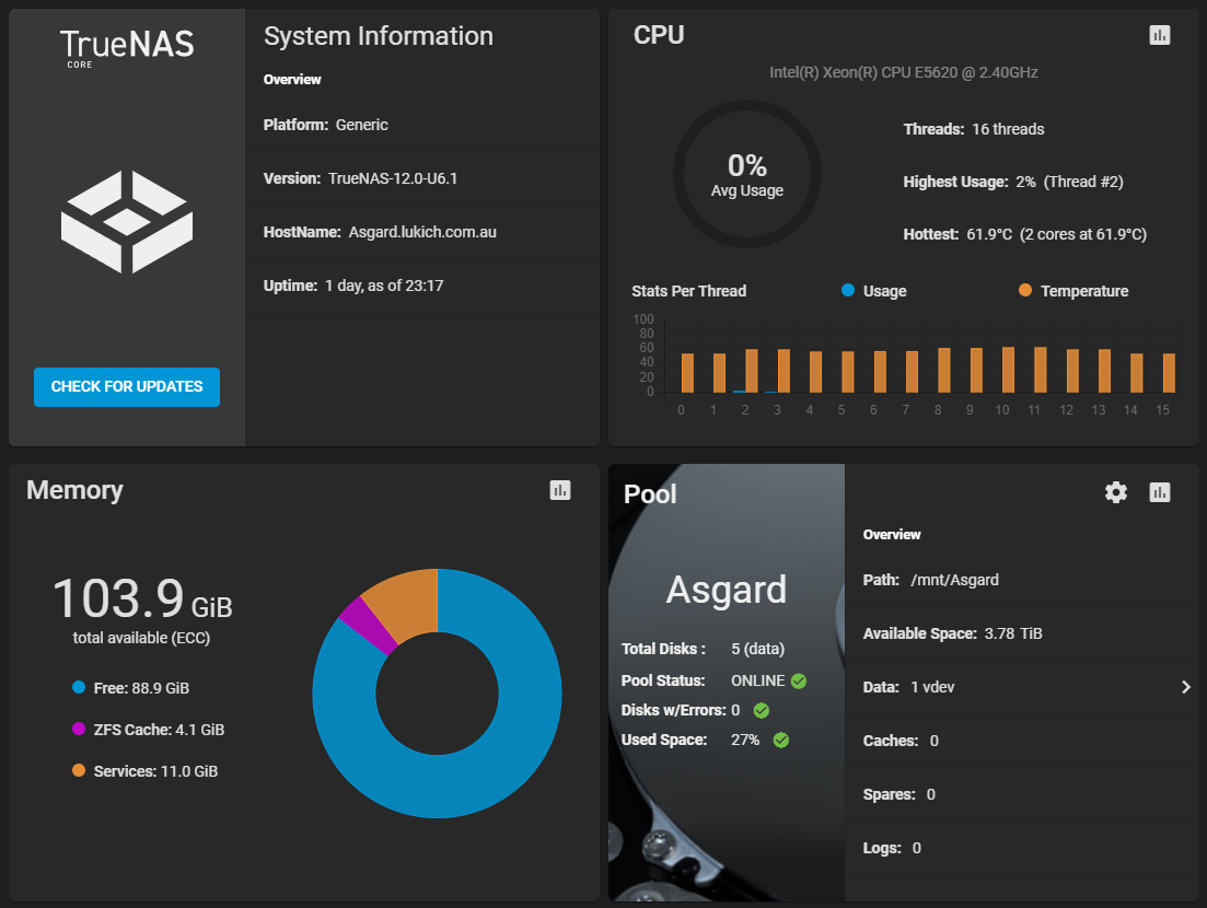

Specs of Asgard are

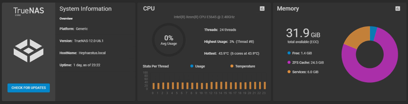

Specs of Hephaestus are
