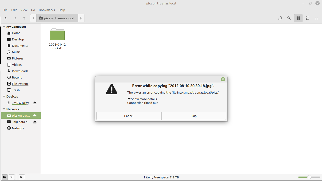

I decided that since I could access the NAS via my laptop I would troubleshoot the plugins and updates at a later time and instead wanted to focus on having the space to backup data/photos now. Only to no avail! Anytime I attempt to copy ANY data over through the network it stalls and I get this window >>
And this happens to any kind of data I attempt to copy over to the NAS. I even can see the folder along with some photos that I copy over but when I try to access the pictures I get a window that pops open telling me that I "Could not load image "file name" Error interpreting JPEG image file (improper call to JPEG library in state 200)

'I decided that since I could access the NAS via my laptop I would troubleshoot the plugins and updates at a later time and instead wanted to focus on having the space to backup data/photos now. Only to no avail! Anytime I attempt to copy ANY data over through the network it stalls and I get this window >>
