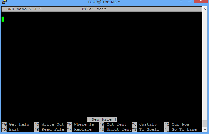

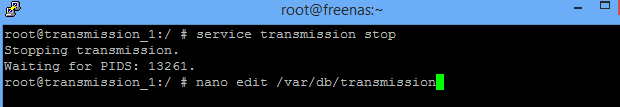

What is the correct command to enter transmission 2.90 config file
I'm using freenas 9.3 stable and I use nano for my editor my editor
all I want to do is change the call script when torrent done from "false" to "true"
and the result is
thanks in advance

the command would be the below
nano /var/db/transmission/settings.json
But, you shouldn't be editing that setting in the config. If you make the value for "Script Torrent Done" blank the plugin has some logic to change 'script-torrent-done-enabled' to 'false'.
