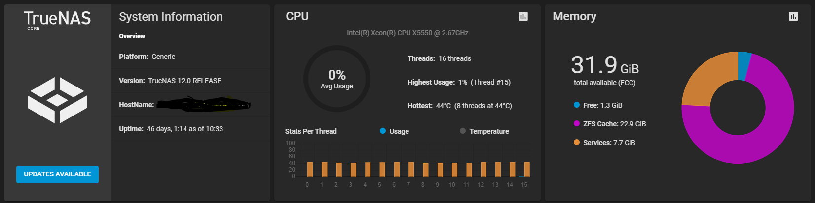

My server is a dedicated hardware with 32GB of mem, and 16 cores.

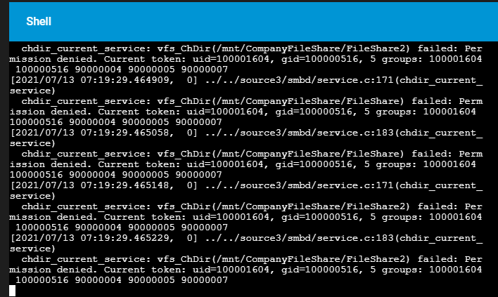

Thanks. I didn't realize that's where you meant. I disabled it but I'm still experiencing the issue. I started to tail /var/log/messages and saw a few instances of this....
I'd like to look more into the smb logs, but there's just so much there I'm not sure what I'm looking for. If I tail /var/log/samb4/log.smbd, I see some permissions issues
9,702
Well, crashing SMBD would certainly produce at least some of the results you're seeing. (but doesn't explain NFS shares also unresponsive)
you might also want to look under /var/db/system/cores to see if you have any dumps in there... then sharing those with @anodos might be useful together with raising a support ticket.
