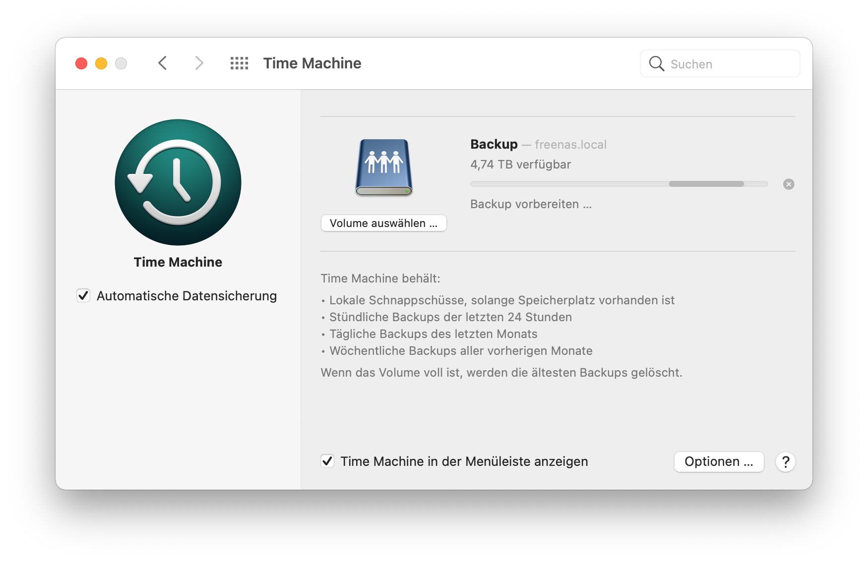

I just noticed that on my wife's Macbook the "Backup" share is shown with over 4 TB of available space. Which is the remaining free space of my zpool. This was not the case some time earlier, but I cannot tell when that changed. I use an SMB auxiliary parameter to limit the TM volume size. Seems like that does not have any effect, anymore. TN 12.0-U4.1.

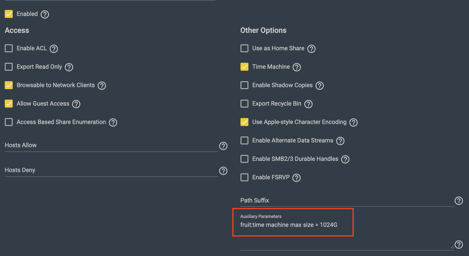

I have only one dataset with guest access for two Macs and I would prefer to keep it that way. The auxliary parameter I cited used to work.

root@freenas[~]# testparm -s
[Backup]
    ea support = No
    guest ok = Yes
    mangled names = no
    path = /mnt/hdd/share/timemachine
    read only = No
    vfs objects = catia fruit streams_xattr noacl aio_fbsd
    fruit:time machine max size = 1024G
    fruit:locking = none
    fruit:time machine = yes
    fruit:resource = stream
    fruit:metadata = stream
    fruit:encoding = native
    nfs4:chown = true

The fruit:time machine max size parameter is working for me again with 12.0-U7. Let's hope that stays with U8.
