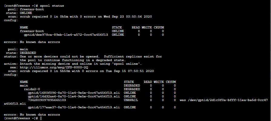

The volume main (ZFS) state is DEGRADED: One or more devices could not be opened. Sufficient replicas exist for the pool to continue functioning in a

I tried to upgrade 9.10 to 11.3 and it failed. So I rebooted in 9.10. After that the main zfs were degraded. I still can access data and has not lost any data yet. I need help :(.
I attached the screen shot

looks like you have lost a disk - 1. thing I would do is to make sure all cables are attached correctly. With the amount of disks I assume you're not using a backplane.
not I am not using backplane. I have checked all the cables. I have made disconnected and reconnected again and again. I try to replace the drive, it shows "Disk is not clear, partitions or ZFS labels were found"
