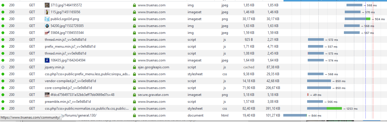

Try running a F12 browser network trace, to see where you're experiencing the delays. It's probably in some of the forum JavaScripts pointing to 3rd-party analytics.

What exactly am I supposed to do? Press F12? And then?

F12 will bring up the developer tools. Select the network tab, and then try browsing to the forums. You'll see the order in which site content loads and how long each piece of content takes to load.
Octopuss
Jan 4, 2019
461
It doesn't tell me anything, but it might for someone else....
Samuel Tai
Apr 24, 2020
5,399

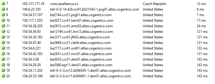

Everything is loading correctly, but very slowly, almost 2 orders of magnitude slower than it should. This sounds like a overloaded link somewhere in the path between you and the SDN that delivers the forum content. What do you see with a traceroute to www.truenas.com?

Samuel Tai
Apr 24, 2020
5,399
Something's going on with the link between Amsterdam and London within Cogent's backbone.

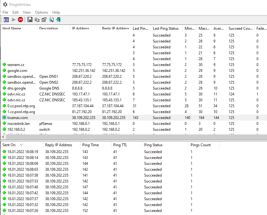

Octopuss
Jan 4, 2019
461
I'm not sure about that, the roughly +100ms is the usual delay when accessing websites physically hosted in the U.S. The increase supposedly still in Europe is weird, but the resulting ping would be 100-150ms anyway.
And there is no loss either, so the problem should be something entirely different. But that's not something I can troubleshoot any further :(
