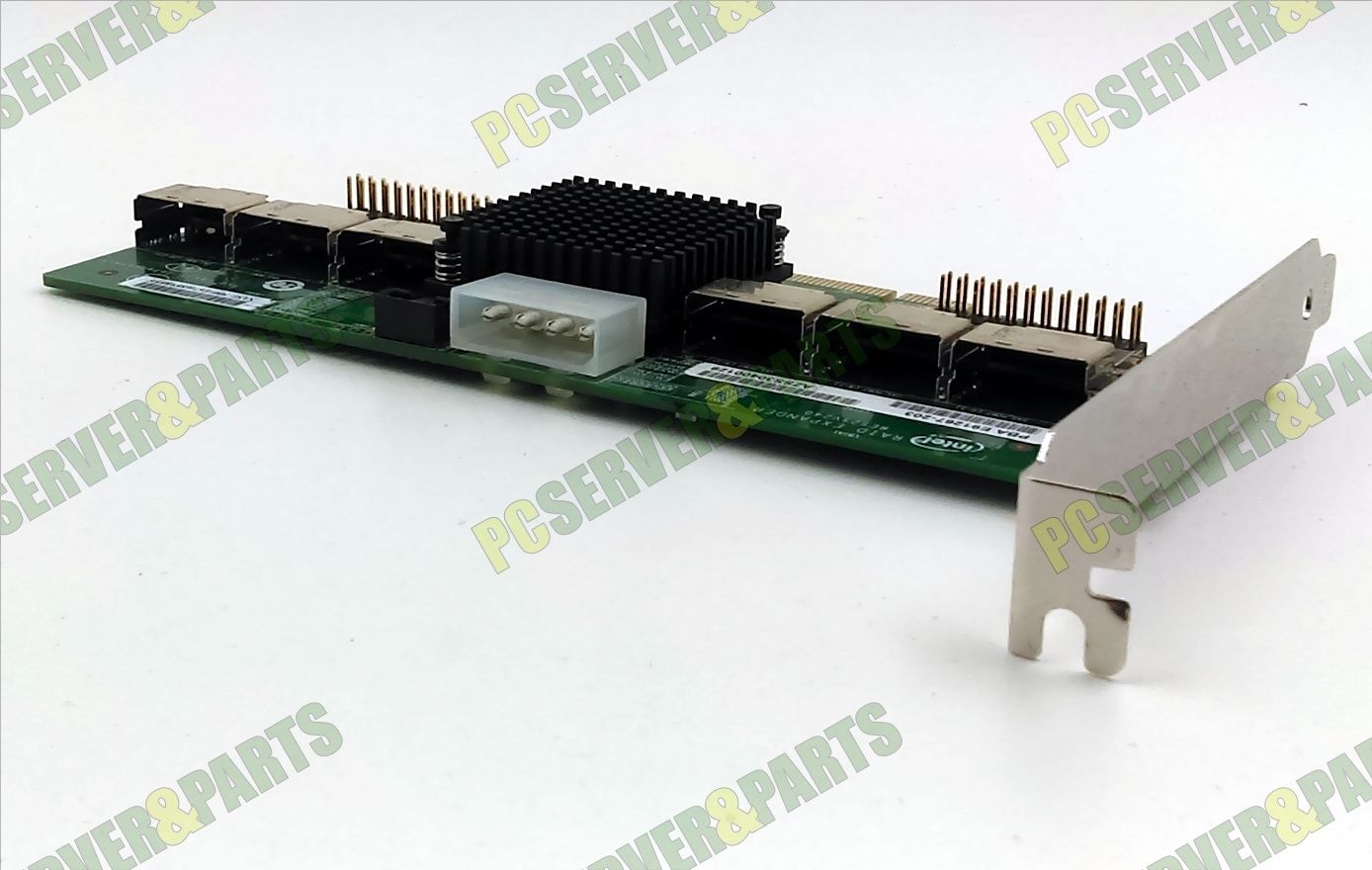

This card: http://www.ebay.com/itm/Intel-RES2S...TA-2x-SFF8087-Cables-2-port-bad-/112559058490
Does not actually need to plug into a slot. It can get power from the MOLEX power port on the top edge of the card. It connects in much the same way as the other.
