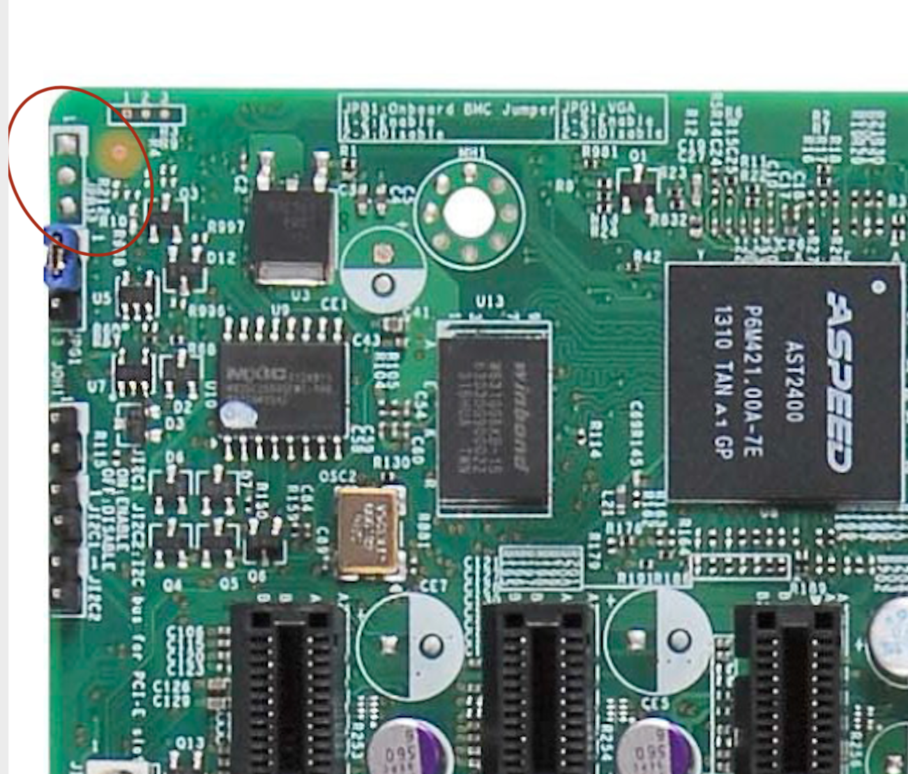

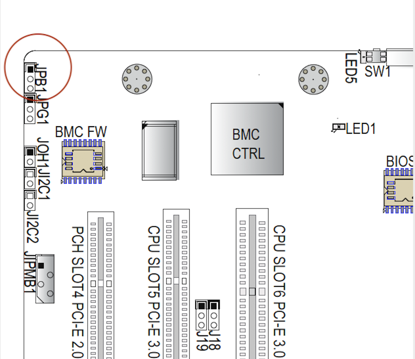

I looked up my manual, and it says to change jumper JPB1 from 1-2 to 2-3 to disable IPMI/BMC. The schematic shows it's location:

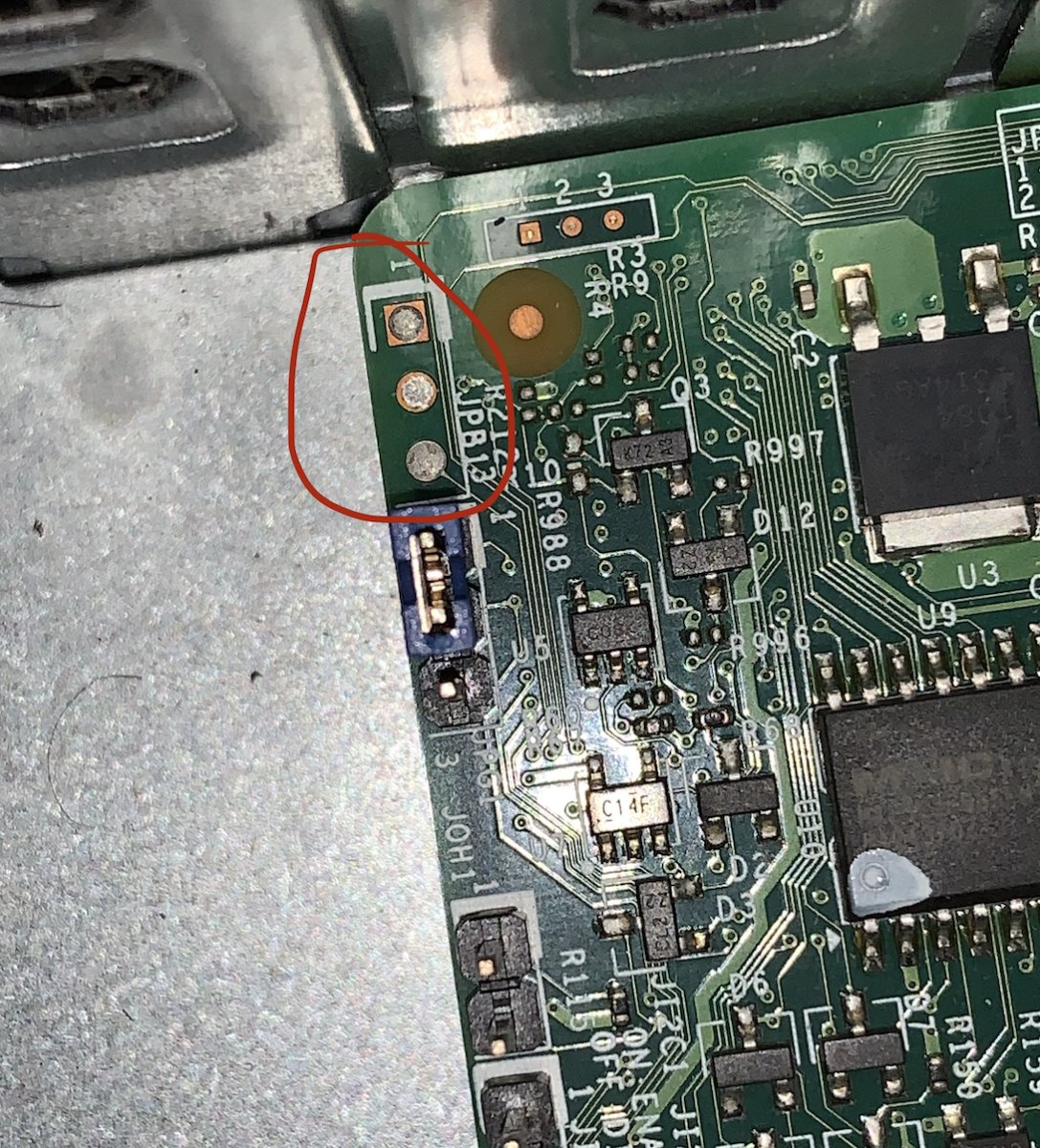

Problem is, my motherboard doesn't even have this jumper.. it's missing!
Looking again at the manual, the photo they provide even shows that it's missing which matches my board, so my board isn't an anomaly or defective:
How the heck do I solve this? My server is dead in the water.

Since you just need to short pin 2 to 3, I would try two ideas: 1 - try a generous line of graphite pencil lead between the two solder points, or 2 - break out a solder iron and solder a short piece of wire between the two points... and cut it off once done.

Okay, I got this resolved!
I shorted Pin 2 and 3 using a flat head screw driver while I booted. I was able to get past POST and boot to my USB Key that was prepped to run DOS using Rufus.
I then ran the bios update from the DOS prompt using the AMI.bat file.
I rebooted, and it continually looped again. I shorted the pins again, got past POST and then got into bios and did a "reset". Rebooted and everything worked, no more looping.
I then went back into bios and setup my bios options how i like and i'm set.
