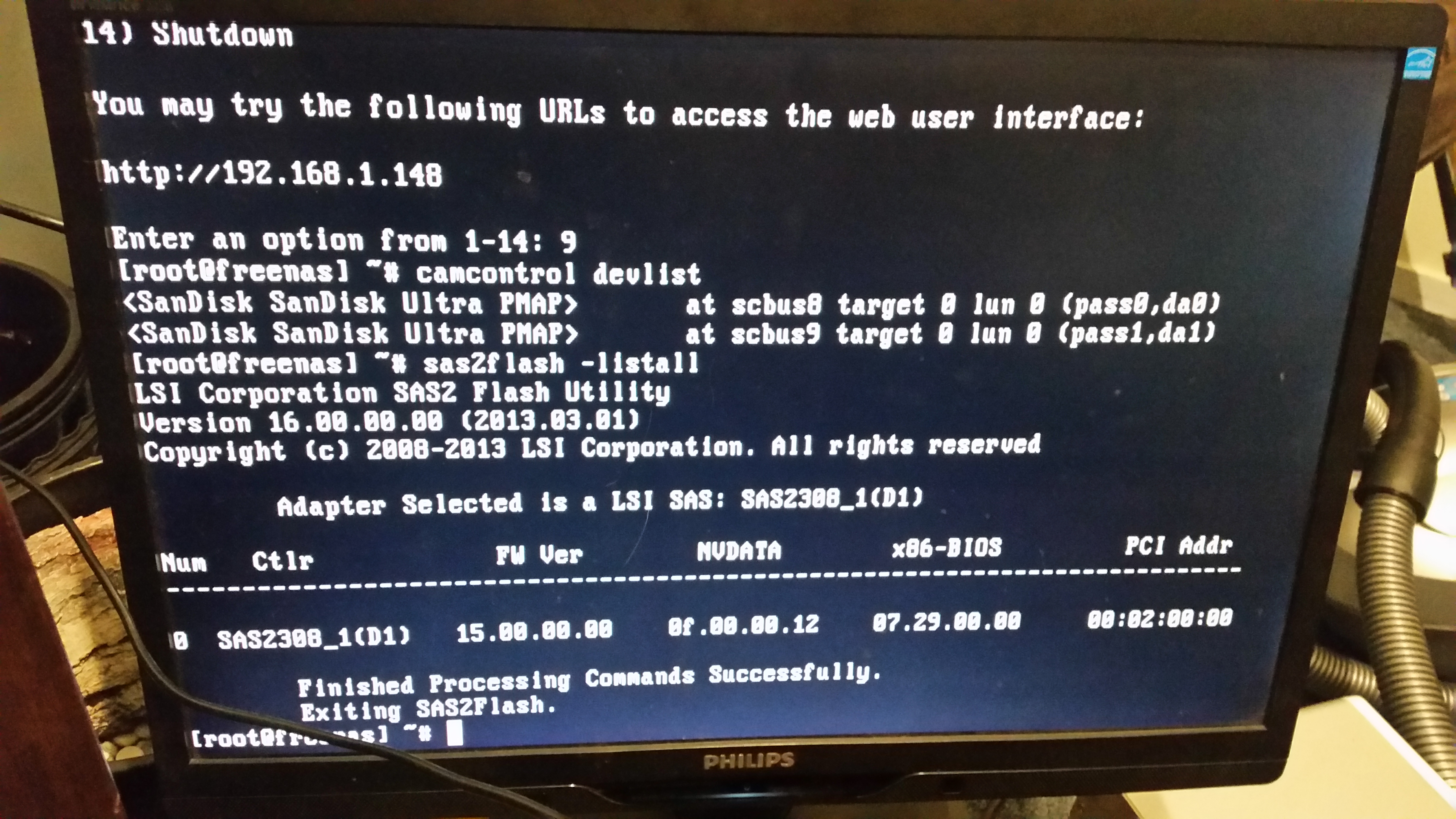

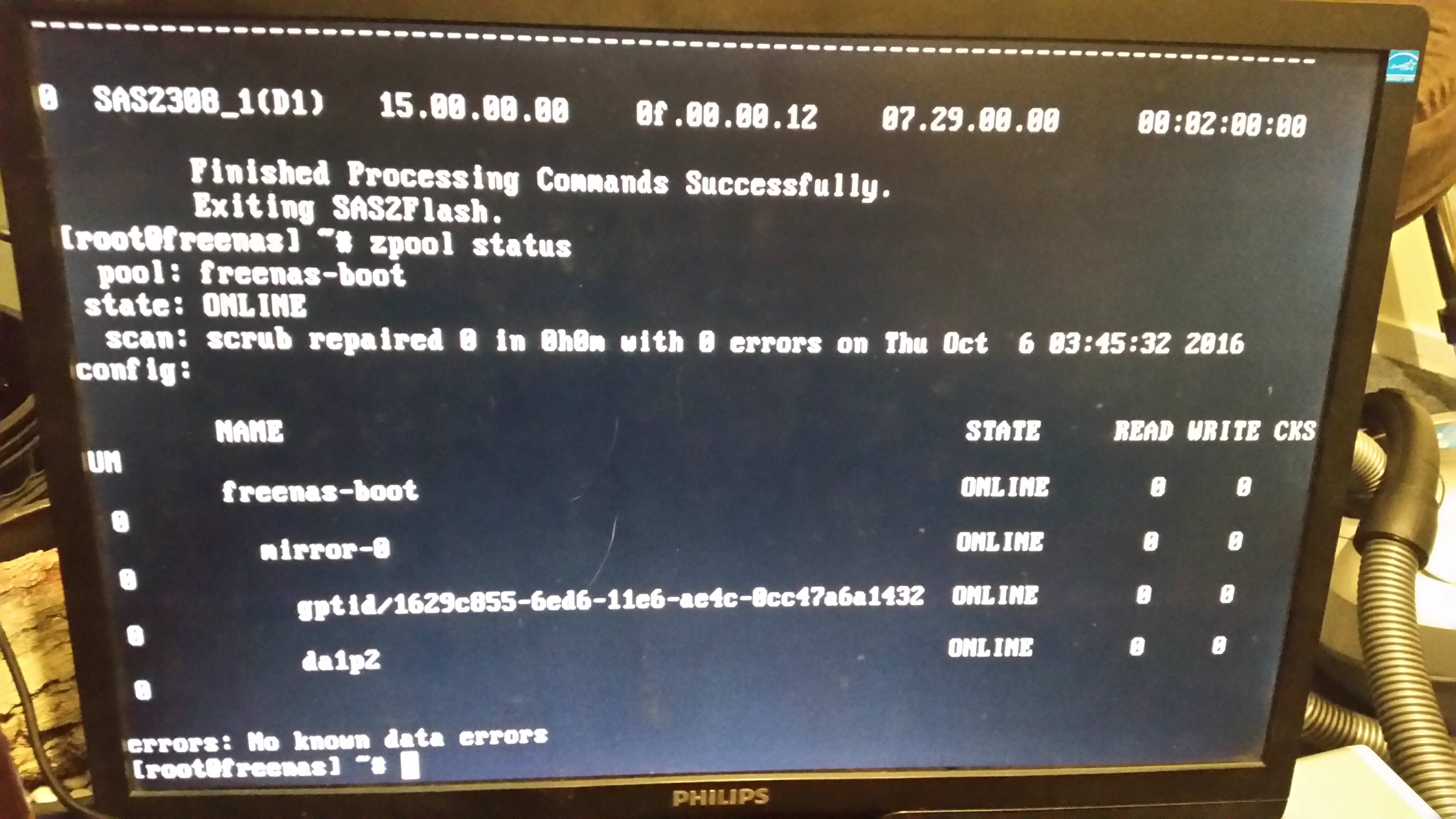

FreeNAS version 9.10.1 (d989edd)
Here goes took some photos with my phone hope that's ok?
The first two commands
Ok, first of all, try replacing every single SATA cable you're using (and make sure they're all shorter than 1m).
Also, flash the SAS2308 to P20 firmware, P15 is way out of date.
