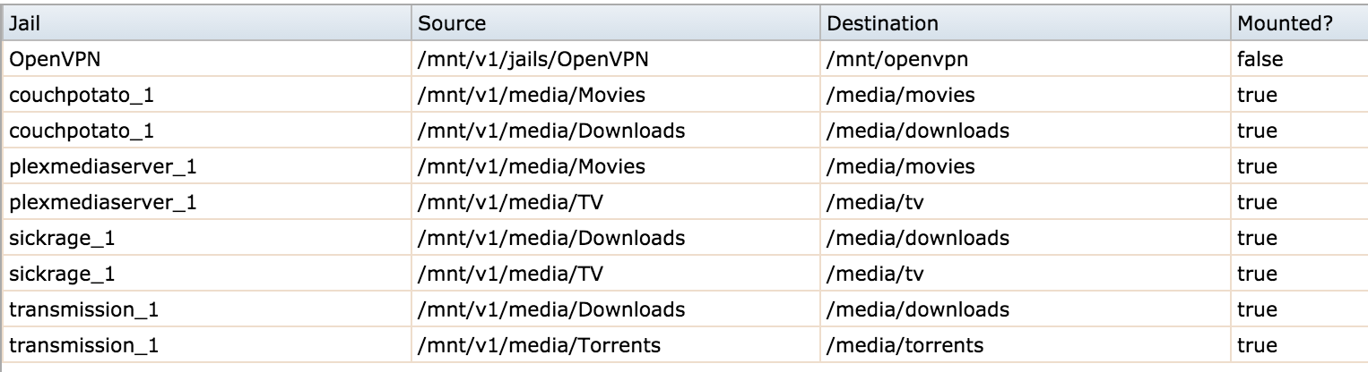

What information do you need to determine how the storage is mapped to the jail?
A screen shot of the Jails -> Storage page would be a good start.

OK, pretty much as expected. So, if you do 'ls /mnt/v1/media/TV', 'ls /mnt/v1/jails/sickrage_1/media/tv', and 'ls /mnt/v1/jails/plexmediaserver_1/media/tv', you should see the same things in each. Those aren't multiple copies of the same material; you can think of them as symbolic links to the original, which is at /mnt/v1/media/TV. If you delete a file at any of those locations, it will disappear from all of them.
Okay I see, is there a way to fix this/ solve this issue?
15,504
There's nothing to fix, and this isn't an issue--it's simply the way storage works with a jail. Why do you think this is an issue?

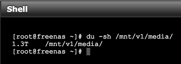

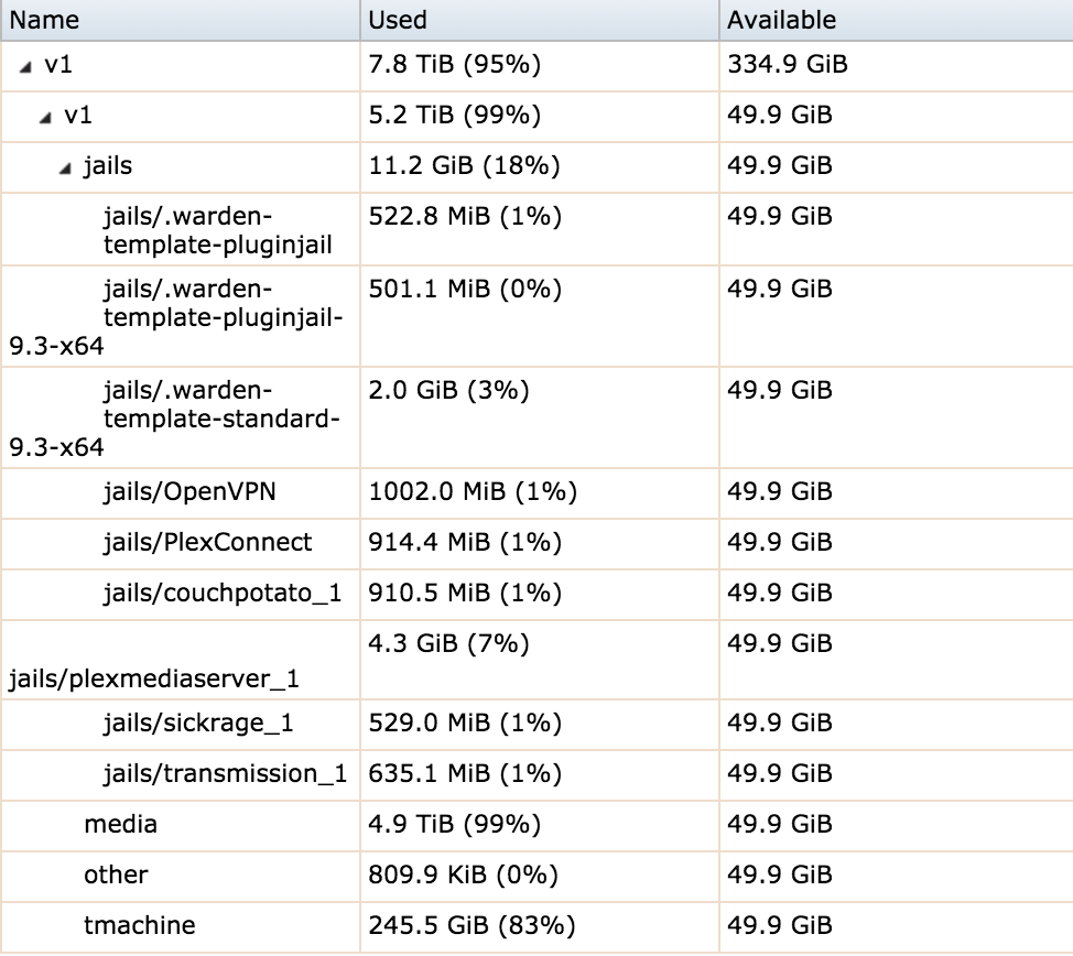

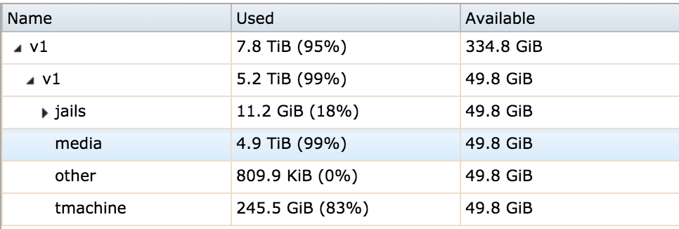

I just deleted several movies and TV shows, and nothing has changed on the storage overview (even after a reboot). So I checked the size of /mnt/v1/media via shell and it is different from the one listed in the storage tab:
Any ideas?

15,504
So even though you delete files, the space is still taken in the snapshots. You can either wait for the snapshots to expire, or manually delete them.
