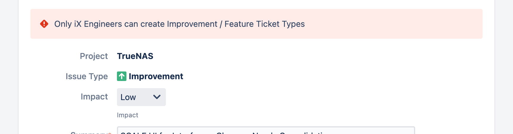

I attempted to do this, created an account, created a ticket as an "Improvement", then clicked create and it said only IX engineers have permissions to do this then it locked the type field and I can't change it forcing me to create the ticket all over again. I would like to help but that was a frustrating experience as well so I'll pass on creating the ticket again. That flow could use some work also. :)

Apologies for the confusion.
As a community user, you make a "suggestion"... it then gets upvoted by other users and then our engineering team decide whether to make it a planned improvement.
