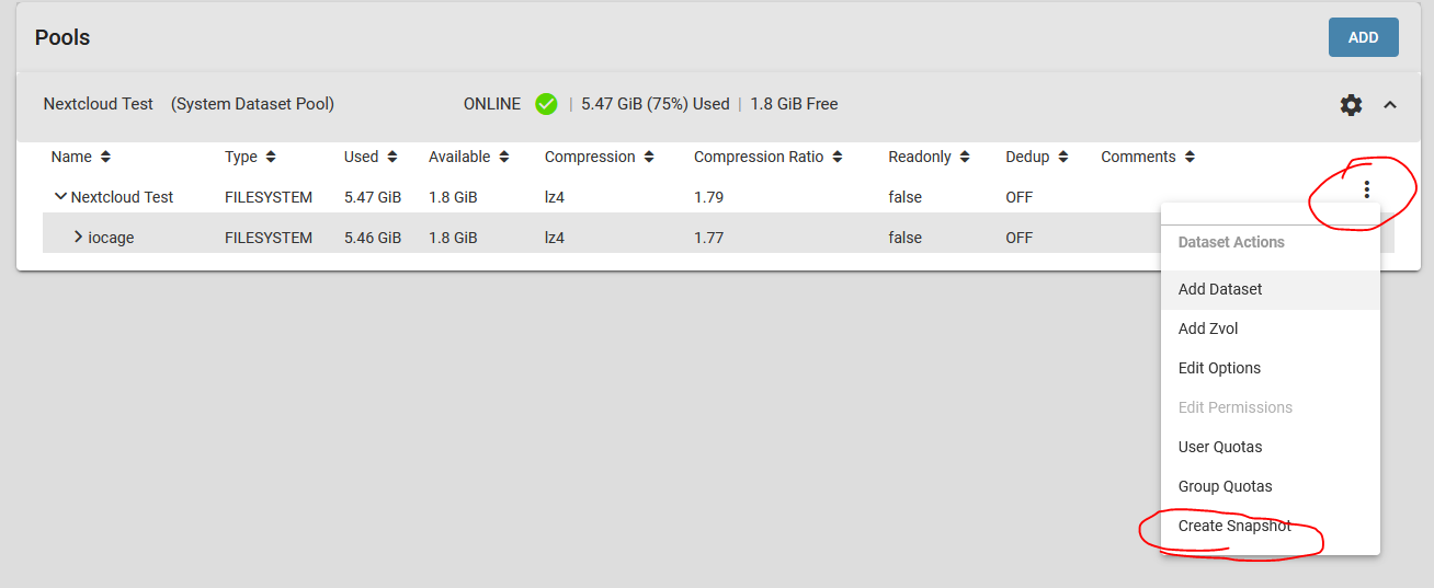

Not taking a recursive snapshot? You need to snapshot <yourpool>/iocage/jails/<nextcloudjail> and all datasets below.
Not sure what you mean by taking a snapshot of the pool. You cannot snapshot pools, only datasets and volumes.

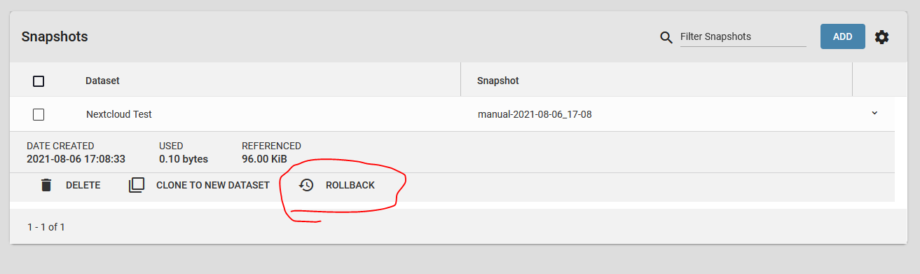

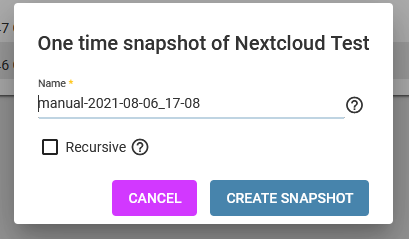

Hi Guys, Sorry for the delay i have been away for work,
sorry for the bad explanation, i have taken screen shots showing the process i was doing
Take snapshot of Nextcloud Test
after taking snapshot carry out update reboot nextcloud and log in to check update worked,
then roll back the update restart nextcloud and check, and nothing rolls back.
i am clearly doing something wrong
again thank you for your help.

think that snapshot may need to be recursive
Patrick M. Hausen
Nov 25, 2013
7,776
Of course :wink: Otherwise you are just creating a snapshot of a mostly empty top-level dataset that exists only for management purposes.
daniel87655
Jul 19, 2021
11
ok thank you, so recursive takes a snap shot of everything below that, i assumed taking a snapshot of the higher level would include everything below it.
when taking a recursive i just have to roll back all the snapshots it takes and it should work fine yeah.
