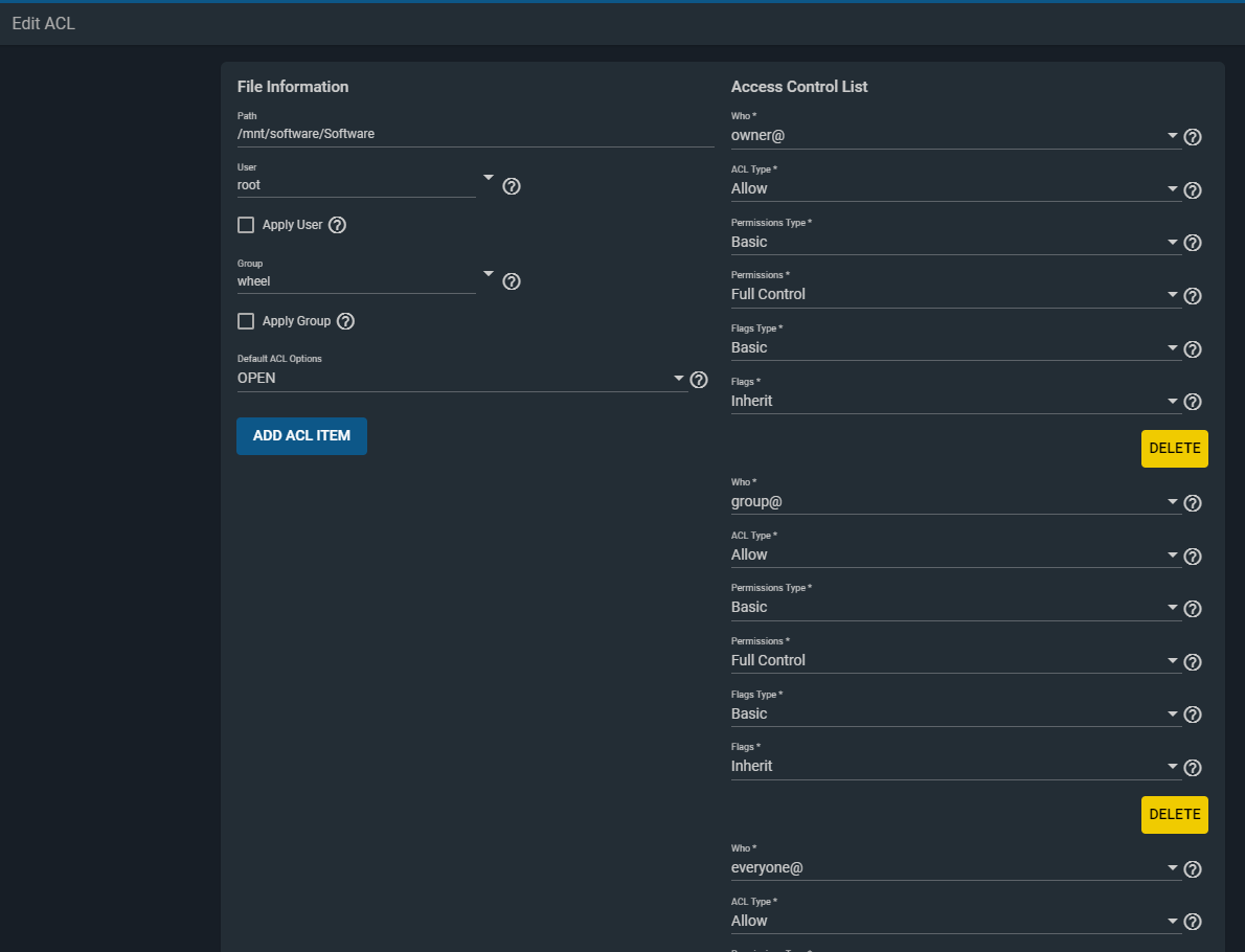

So far I have done the following:
1 - Created a Pool called Software
2 - Created a dataset (SMB type) called Software
3 - Enabled ACL using Default ACL Option as Open:

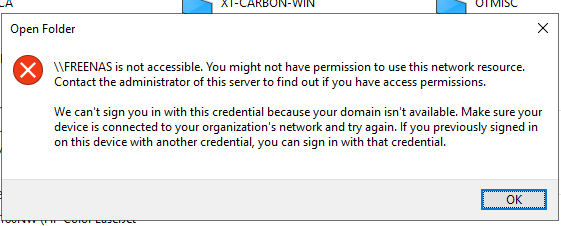

I have confirmed that the SMB service is started, and that the freenas IP can be resolved, however when I try and access the freenas I get the following error:
Has anyone come across this issue and if so have you found a solution?
I get the error even if I try and access from the Domain Controller directly.

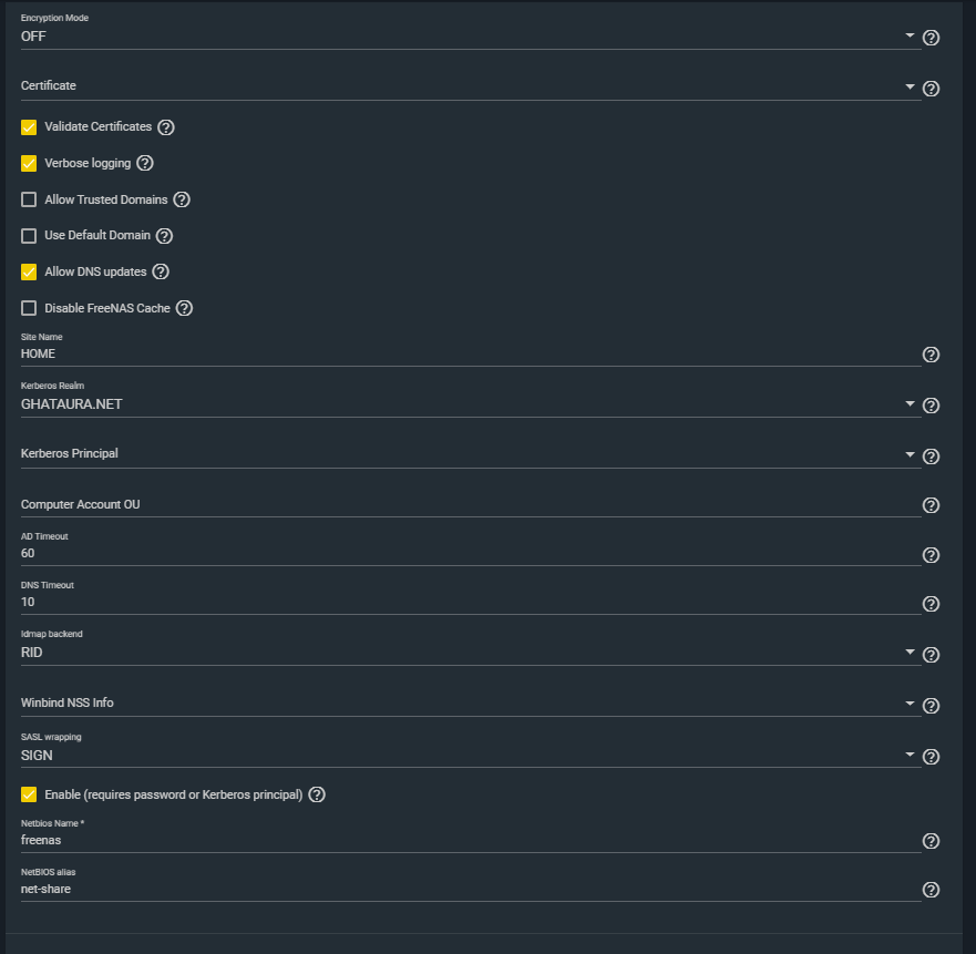

What's the output of midclt call activedirectory.get_state?
SunnyG
Sep 8, 2018
33
Hi Anodos,
Thanks clicking on it informed me that the SPN couldn't be set, so I tried with a Admin account and it showed as started, I now can access the network share, but now its prompting for a username and password when I try to connect to freenas, I will dig around and see if I have miss configured the pool or dataset.
Thank you for your help and pointing me to the write spot.
