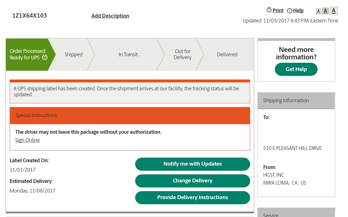

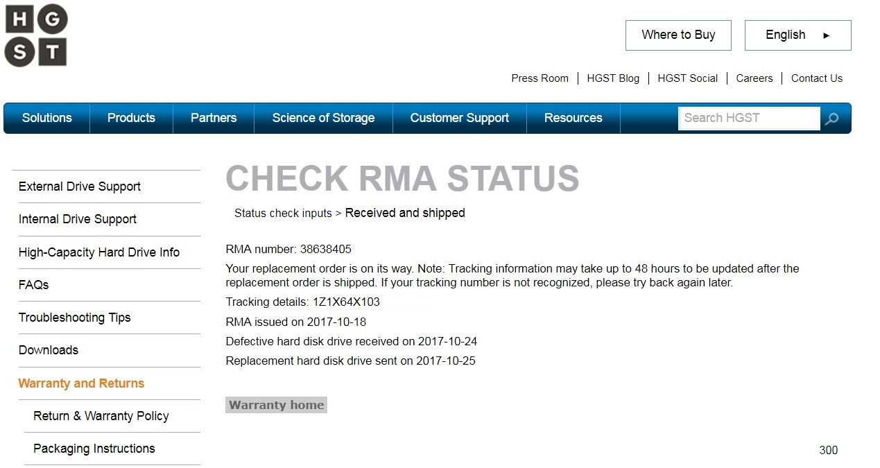

Well, WD/HGST is really dropping the ball on getting the replacement sent or so it seems to me.
Got the RMA issued on the 18th of Oct. Shipped it off the 19th and it was received by someone on the 23rd. Dropped them a line to check and make sure it was received and dealt with rather than tossed in a corner and it was shown as processed on the 24th. On the 25th a tracking code was issued, so I am thinking a replacement should arrive on the 30th or 31st. Nope, still sitting in "we probably lost it before it got to the truck." limbo.
I know that they switched the drives from being 64MB of cache to 128MB but still if the tracking number is issued why is it sitting unused. I contacted once already and was informed:
I appreciate your continued response and your efforts in helping us resolve this issue. And I sincerely apologize for the inconvenience caused to you.
I have checked that drive sent on 25/10/2017 but new RMA label is created on 01/11/2017 with UPS shipping services.
I have done a couple RMA's over the years and this one so far has been one of the worst I have had to deal with. I almost wonder if they just decided to string me along while they fix the issue in the drive I sent in or patch the problem with a software change and then send it back.
