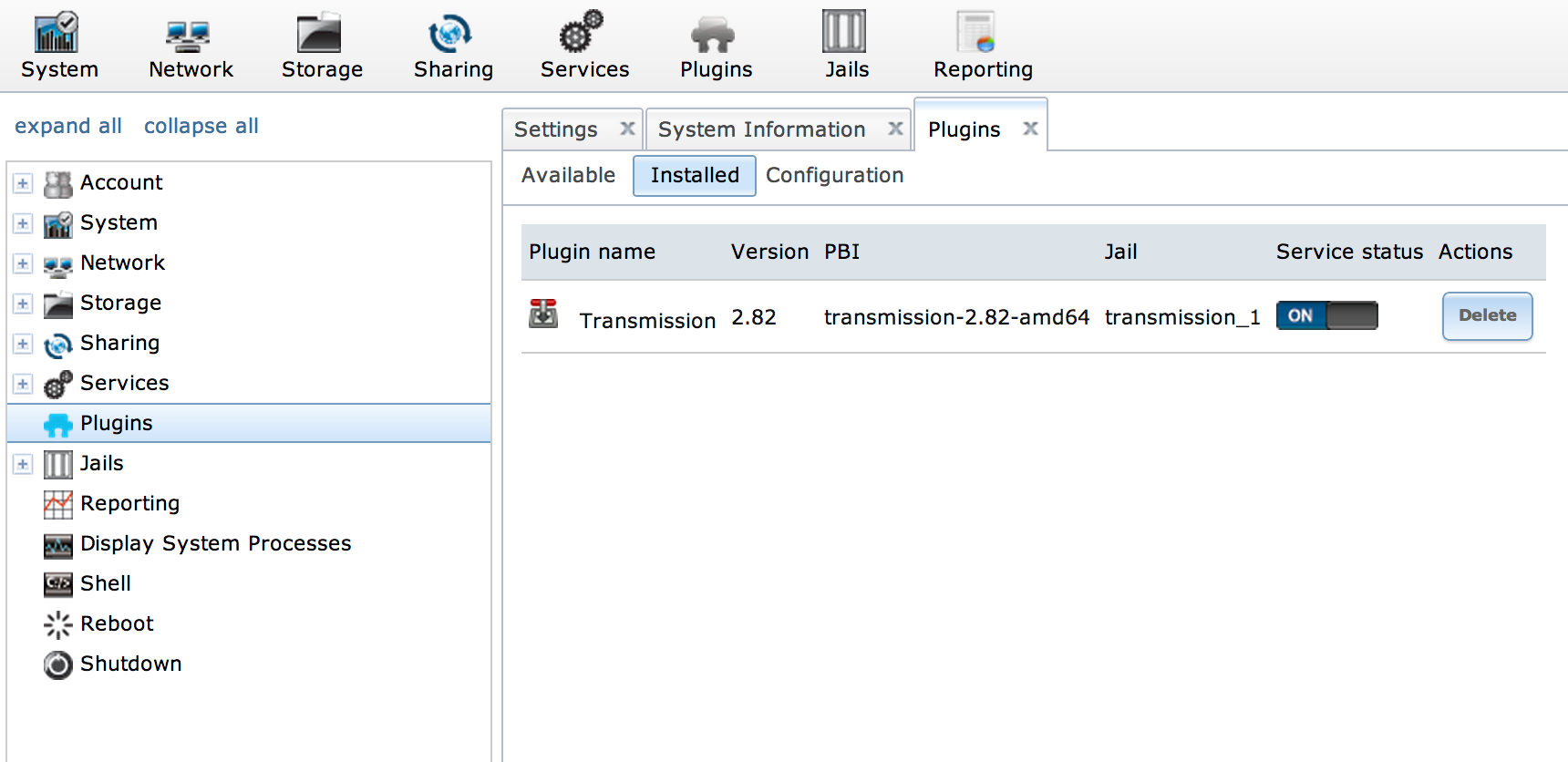

I'm having a similar problem on my HP N40L with 8gb. It worked fine for a year, but I got bit by the multiple jail template bug (where it kept making more and more copies of the same template) when I upgraded, so I completely wiped the usb stick and reinstalled 9.2.1 by running dd to copy the image directly onto it. I also deleted all zfs data sets except for my main one for local file sharing before reinstalling from scratch. I then upgraded to 9.2.1.2 a week later.
Now, the left bar takes on average 2-3 minutes to open (it has the 3 bar "loading" animation during this time). The plugins tab does the same. The left bar has no + before plugins, either, so I can't configure transmission (which is the only plugin I have at the moment on my new install). In /var/log/messages I get this:
Mar 10 21:48:32 odin manage.py: [freeadmin.navtree:526] Couldn't retrieve http://10.5.0.10/plugins/transmission/1/_s/treemenu: timed out
I also get massive amounts of these in /var/log/messages now (10.5.0.50 is my laptop). Not sure if there's any relation:
Mar 10 21:51:06 odin smbd[30339]: [2014/03/10 21:51:06.571004, 0] ../source3/lib/util_sock.c:941(matchname)
Mar 10 21:51:06 odin smbd[30338]: [2014/03/10 21:51:06.571008, 0] ../source3/lib/util_sock.c:941(matchname)
Mar 10 21:51:06 odin smbd[30339]: matchname: host name/name mismatch: 10.5.0.50 != (NULL)
