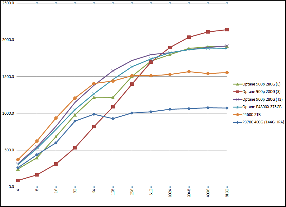

It's a long thread, but there is a collection of SLOG benchmarks here.
Your Intel P3700 is among the heavy-hitters, the "prosumer" Optane 900p/905p is also well-represented, as of course are the "enterprise" Optane DC P4800X and P4801X. A popular used/refurbished device is the Radian RMS-200, a battery-backed NVRAM card with 8GB of space.
Trying to crosslink a graph here, hopefully it works. A bit out of date in that I need to add the RMS-200/300.

I was trying to find the graph in the thread, I get that the x axis is size, what is the y axis?
Sorry about that. X axis is the ZFS recordsize in kilobytes, Y axis is transfer speed in MB/s. Need to add some minor gridlines for sure.
