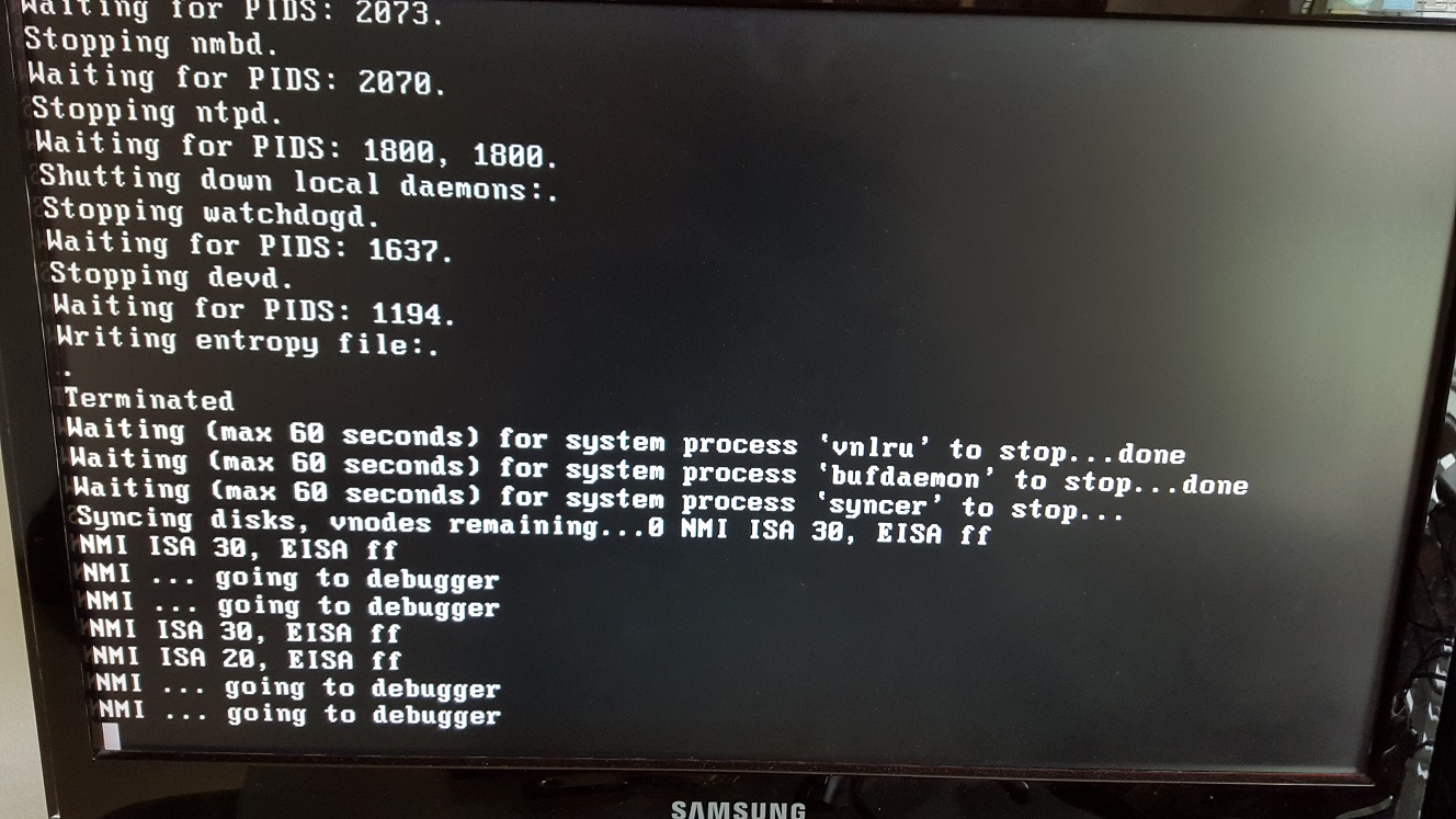

sometimes while syncing disks instead of:
"Syncing disks, vnodes remaining... 0 0 0 0 0"
the following shows
"Syncing disks, vnodes remaining... 0 NMI ISA 30, EISA FF" & "NMI ... going to debugger"

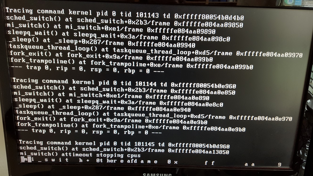

after that, the output goes crazy with a
"Tracing command kernel pid 0 tid XYZ"
where where XYZ is an increasing integer (picture's of both screens attached)
anyway, at this point it just remains until I manually power off the PC ...

I found the service that produces the problem:
watchdogd!
when I deactivate it manually, i.e. 'service watchdogd stop' the problem occurs sometimes ... but when disabled during runtime, no problems at shutdown!
Question is: what exactly does watchdog and is it save for me to disable it?
if someone knows the answer to this, I'm happy! :)
thanks for your help guys

It's there to reboot the system if the system gets hung or stuck. In theory the watchdog firing is a bad thing because it suggests something else has gone awry. But if your system is being happy without it, that's kinda bad-wrong too.
I see you updated the bug report already, so let's see what devs say.

ok ... so it should actually prevent what it causes now ... strange.
anyway, as watchdog itself seems to be the problem (remember that the problem occurs during shutdown of the watchdog daemon) I'll stick to that solution until someone knows the reason ... I can't figure it out.
