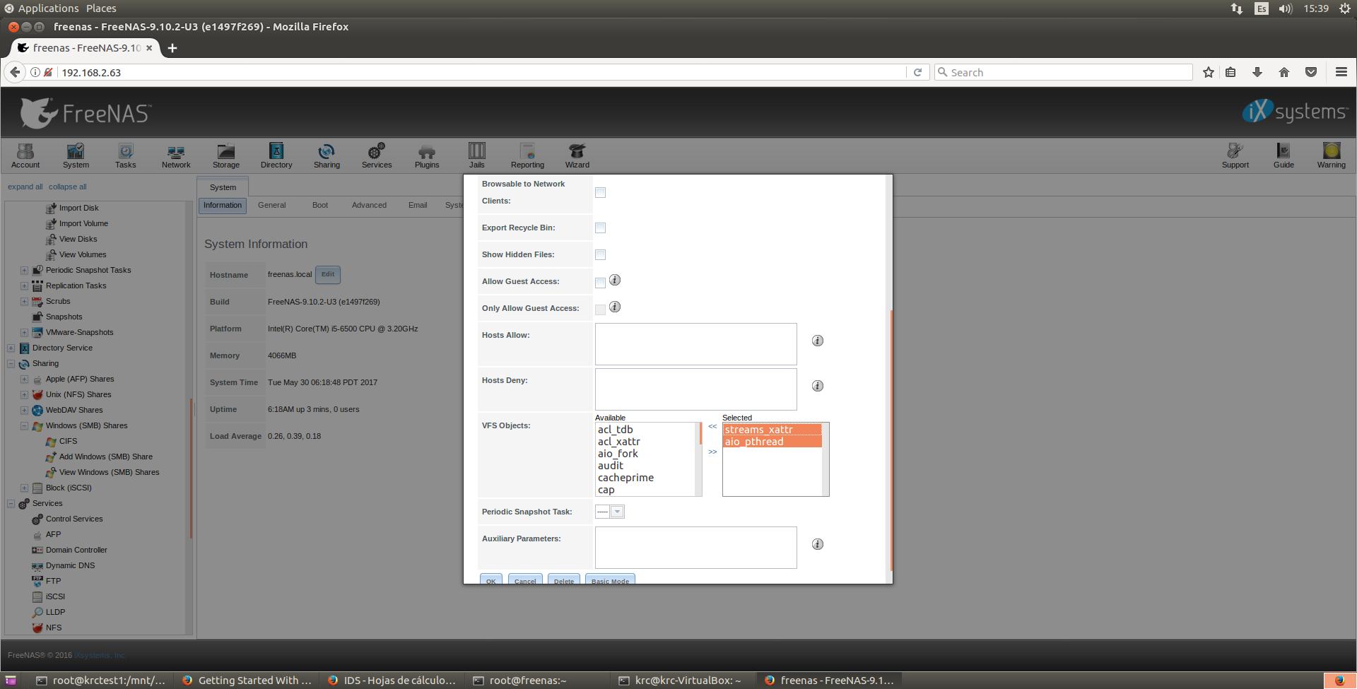

@zoomzoom
These are the default VFS objects.

  1. Make share browseable
  2. Add VFS Object acl_xattr See this post by @anodos below

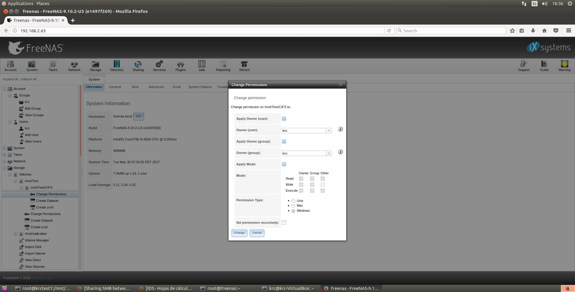

  1. When you created the dataset that's being used for the SMB share, did you select Permission Type: Windows (or it could be Share Type: Windows)?
  2. Is the smb user the owner, or apart of the owning group, for the dataset of the share?

The dataset is set with this configuration:

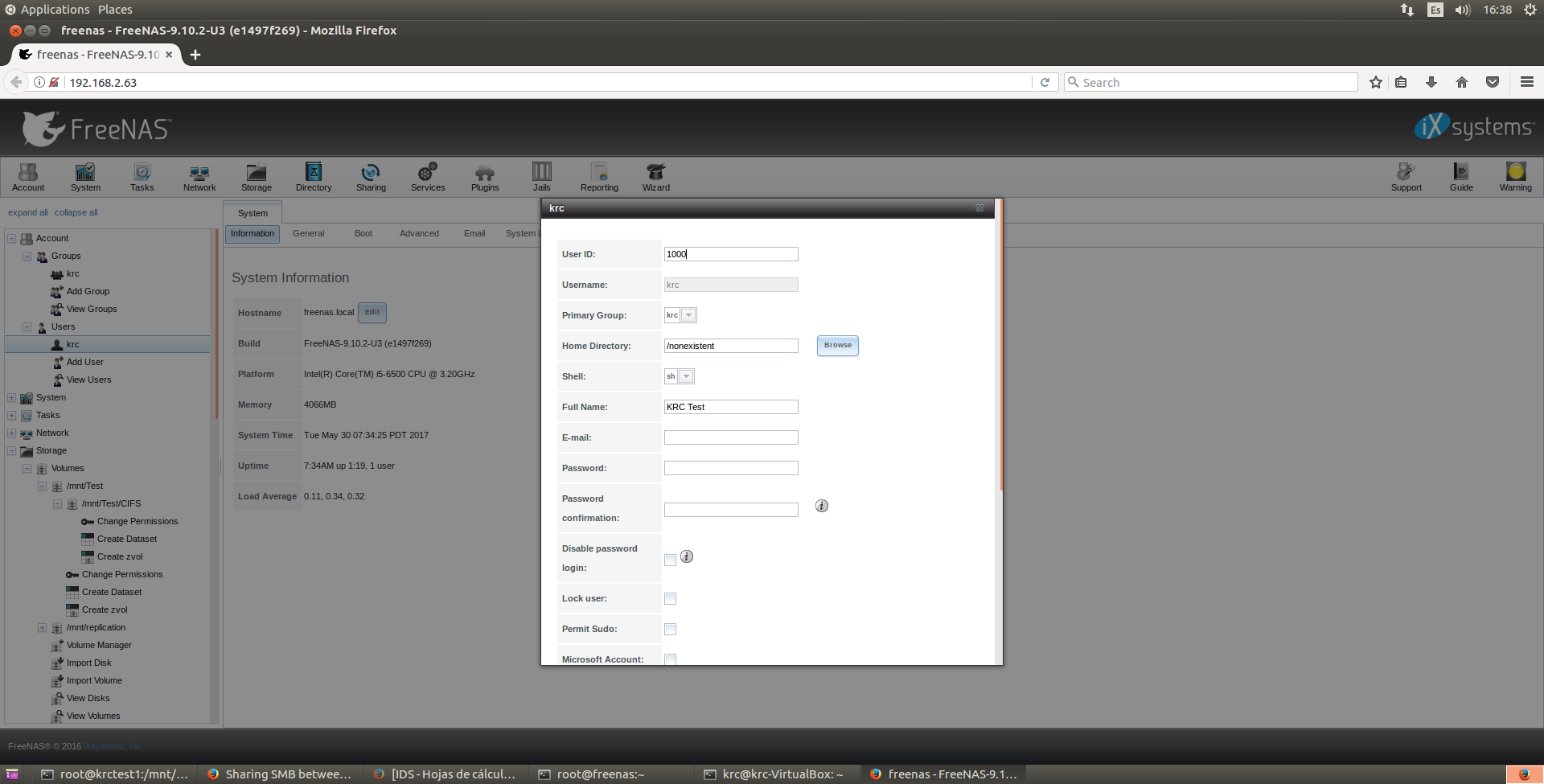

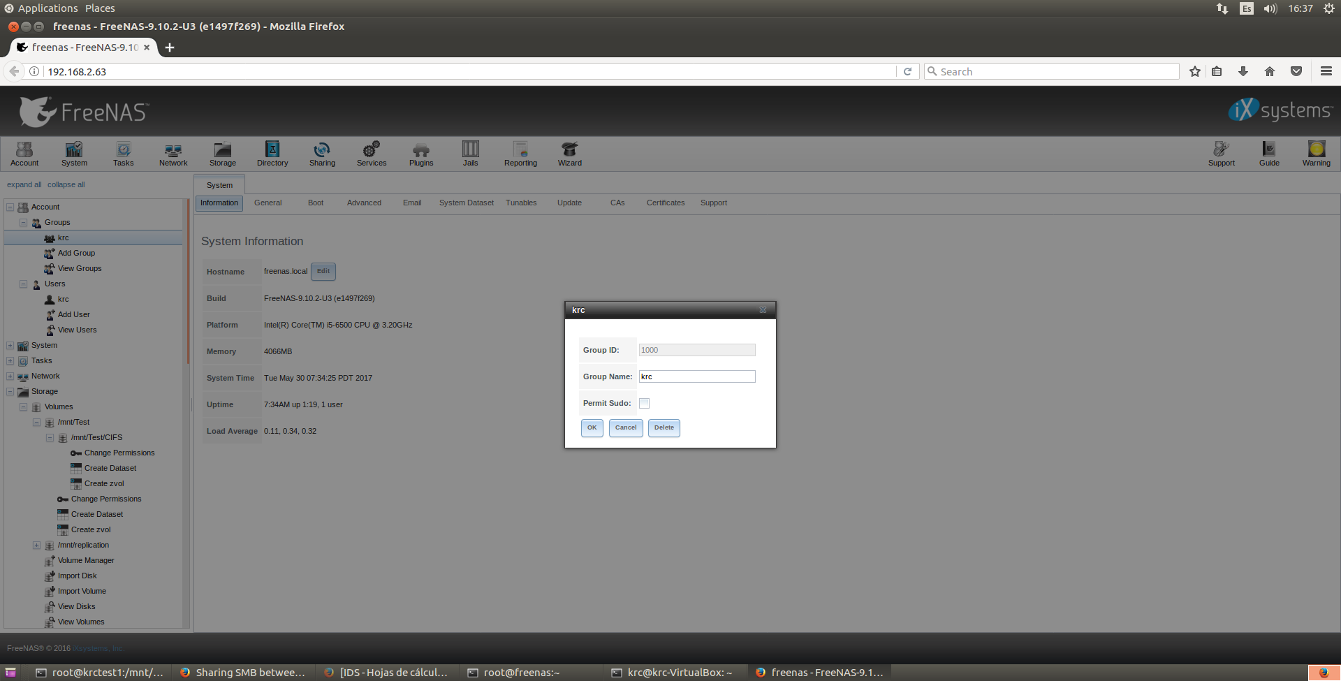

And the information of both user and group is:

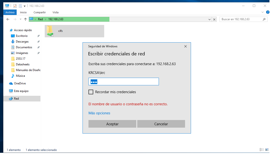

I have been checking Windows access, with same problem... (it is written in Spanish, but I hope you find out it is a mistake also ;)
Thanks in advance, tomorrow I would continue with your proposal, now it is time to finish work ;) Tomorrow I'll check it again.

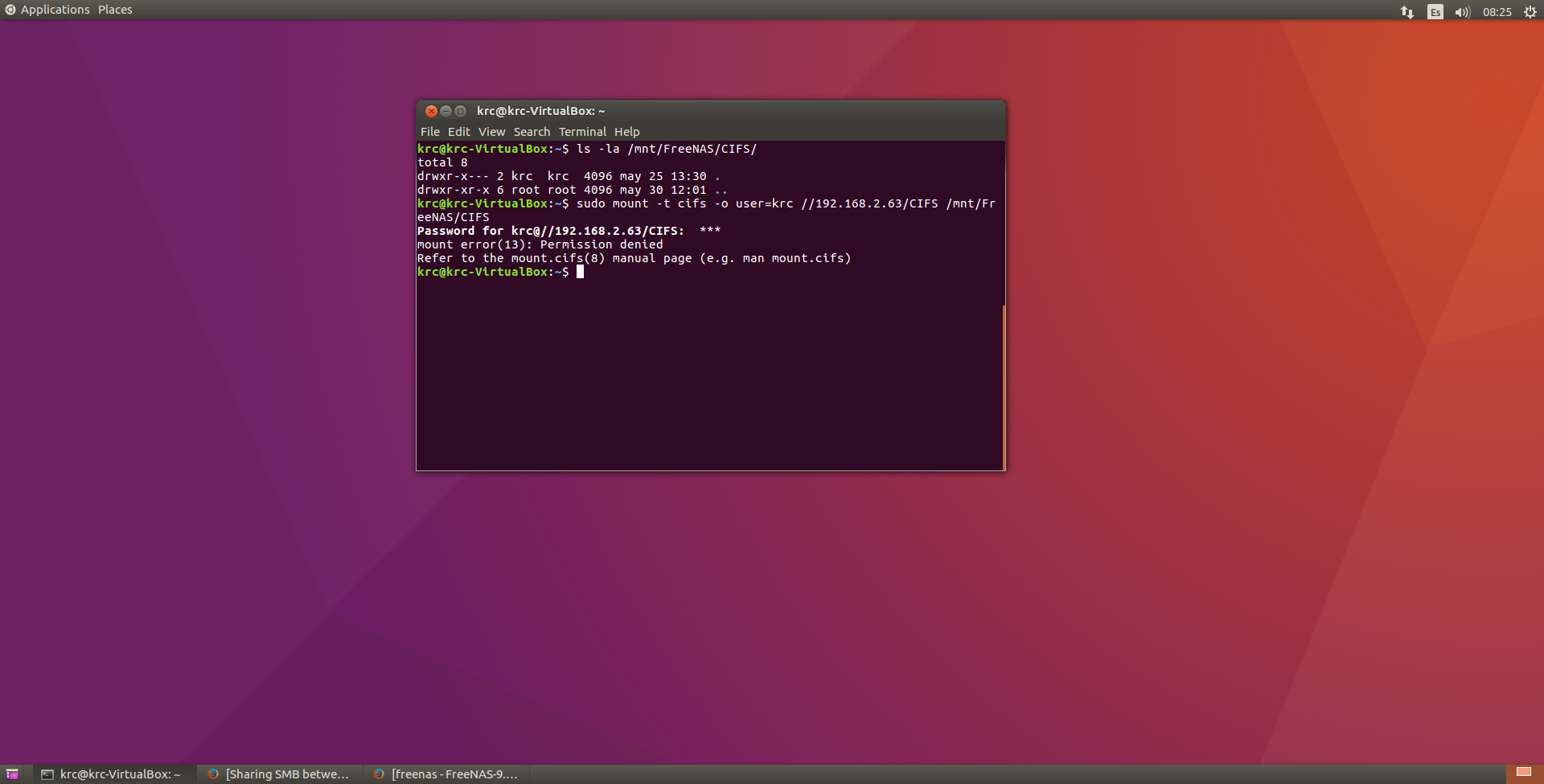

@zoomzoom Thanks for your answer, once again! The first thing I tried is these steps you recommend from Ubuntu, but I am still not lucky...
Everything done after rebooting FreeNAS and Ubuntu. Later I would try from Windows. I am going to reinstall FreeNAS in a dedicated server, and I'll let you know if everything goes fine ;)
