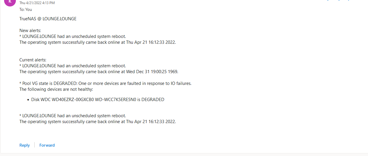

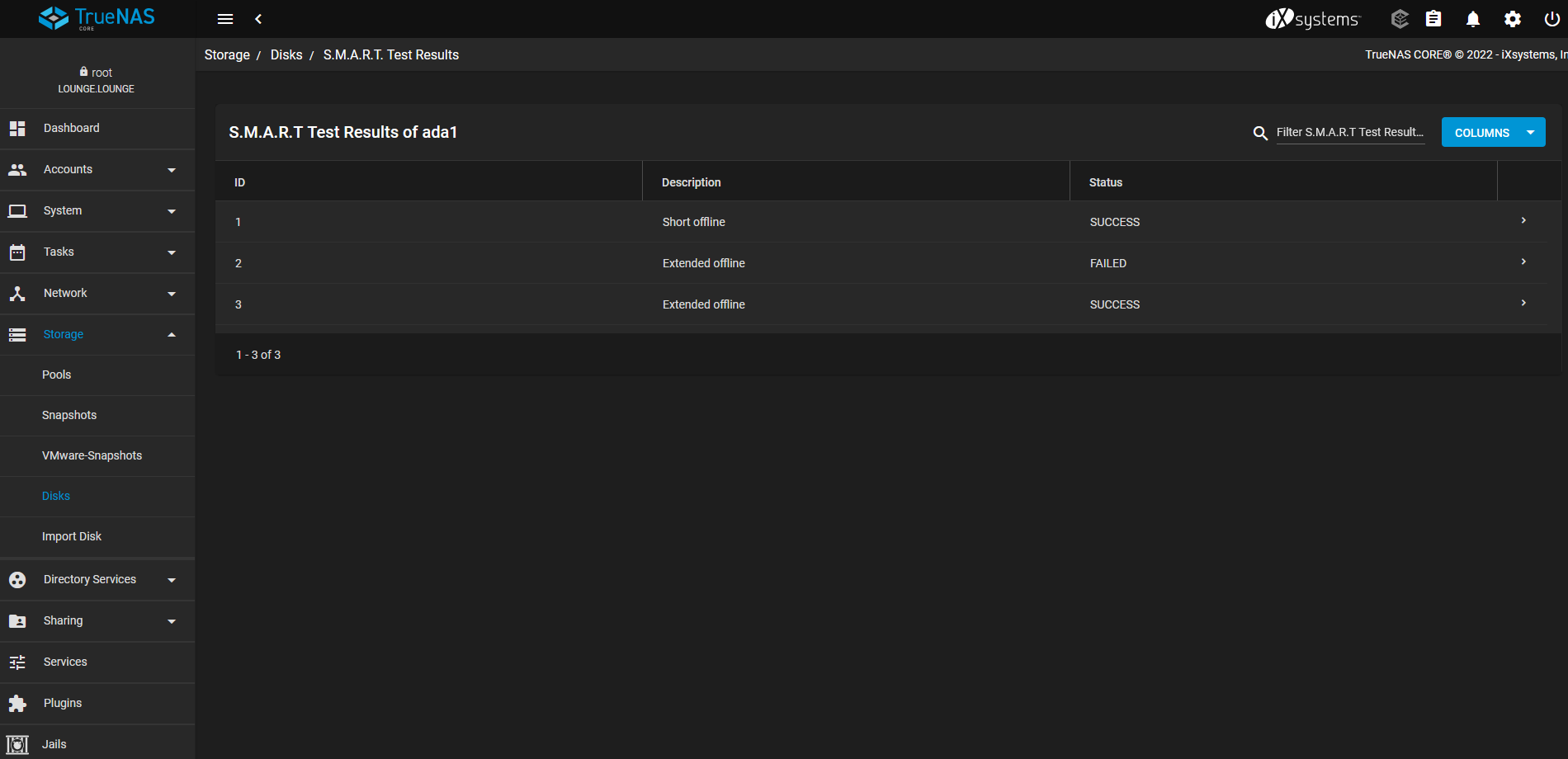

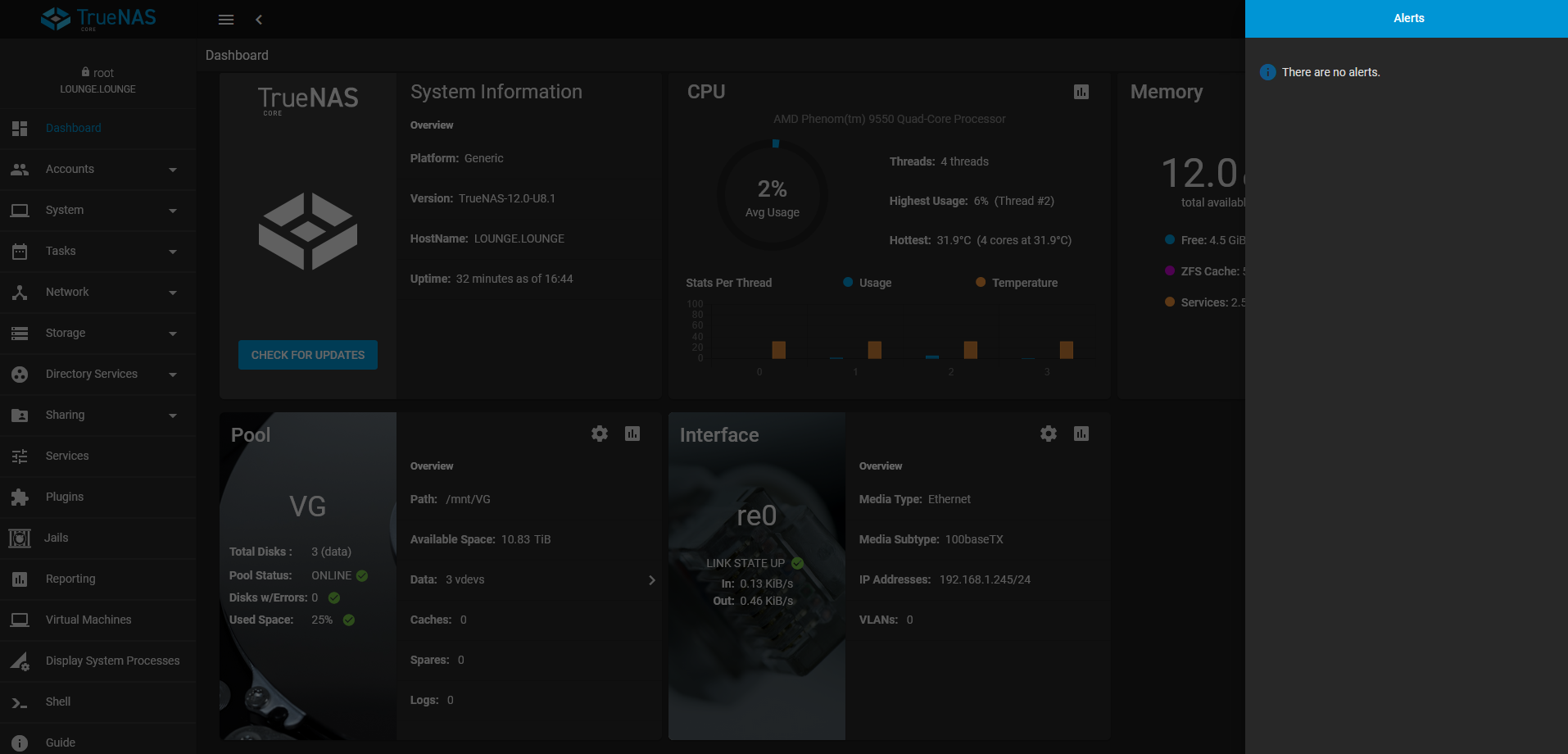

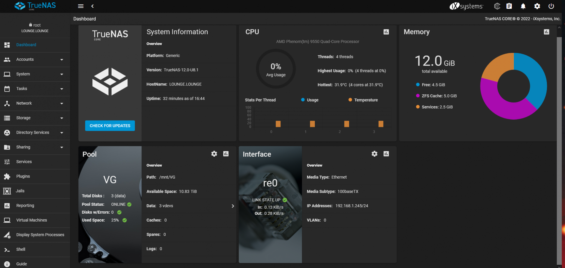

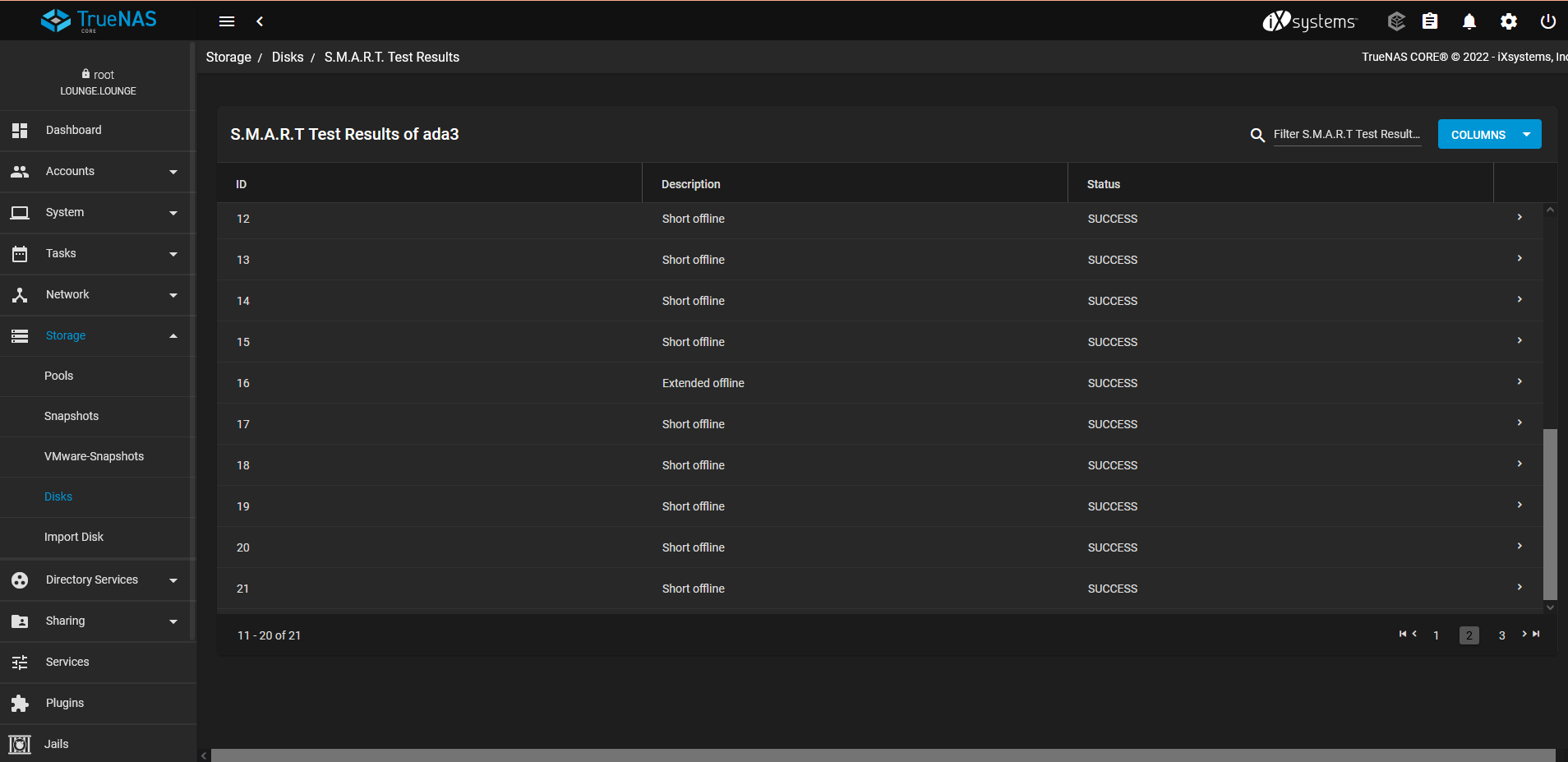

On my server I keep getting error notification from my server telling me there is a issue with the Raid drives but it keeps going away on the side bar and it is not showing a issue on the pool stats of the drives. and when I pull up the SMART report it has 1 success then 1 failed then 1 success, on both Barracuda drives and all Success on the WD Blue drive, any idea of what could be the issue and it only has gotten worse after my system had did the updates yesterday

Your Baracudas are SMR drives and will give these symptoms when used with ZFS.
wolfkid
May 4, 2021
12
Is there settings I need to change for the drives for them being smr
LarsR
Oct 23, 2020
719
No SMR and CMR are different technologies for how Data is written to the drives.
You can't change smr to cmr drives, and cmr drives is what you want with zfs.
If possible RMA the drives and get seagate ironwolf, ironwolf pro or exos drives.
